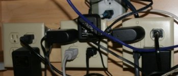

I make my own to meet my needs. It's alot safer than some of the crap in the stores. Plus with everything that uses tranformers these days you can't utilize the powerstrips properly. I go to the home center and get metal boxes and screw them to a block of wood. As far as surge protectors go...Never had one, and I don't trust them. I unplug my stuff in a storm. I also have a gfi in there
