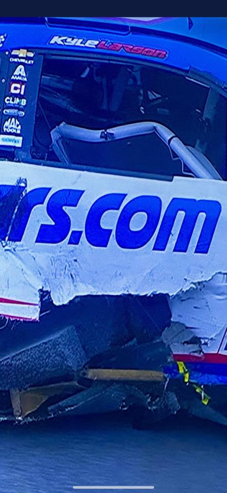

We heard about the head injuries last season with the Gen7 car. Things have been calmer to this point. But the damage to Larson's car shows one reason why NASCAR needs a new car ASAP. They have also made these cars "spec cars" meaning just about everything on them is the same. Then people wonder why fans complain about the racing and the drivers are now complaining about it. Still, a Cup car should not have
the type of damage that Larson's did on Sunday.
I am by no means a roll bar or race car designer, but, didn't the roll bar in the photo do its job in dissipating the impact inertia G's ?
Having said that, if the drivers side had been hit in exactly the same spot at over 170 MPH, I am afraid Larson would be history or fubar. JMHO.
A hit like that has never been witnessed in modern NASCAR. They will evaluate and improve. Just like they did with the 2 or 3 (iirc) wall opening crashes in the early 2000s that destroyed/collapsed/damaged the roll cages (Jeff Fuller at Kentucky is most famous).
You see damage that significant as Preece hit what is the weakest part of the cage. There is very little vertical or horizontal bracing there. Had Preece hit the driver's side the damage would not be nearly as significant. There is about 2x the amount of bars on the driver's side as opposed to the passenger's side.
Last hit like this I can remember that might be close in severity is Biffle hitting Jeff Purvis at Nazareth. Both Kyle's are in much better shape than he was.
Do you not know how that is supposed to work? That's designed to do that to absorb energy. The drivers side would not crumple in that way. Of anything this means the car is doing its job. No matter what people may think NASCAR knows way more about what it is doing then some schmucks on the internet who haven't had a science class since high school.

There’s a reason that car is going to R&D. That isn’t a crumple zone. That wasn’t supposed to fail like that.
“I’m really lucky nothing got me inside the car.”
-Kyle Larson
Yeah they take cars to R&D to analize how the car did in major wrecks and if needed fix the problems. Nascar has been doing that for years. The drivers area is constructed differently than the passenger side.

Had the bars not given like they did its likely both Ryan and Kyle would have been injured.
When everyone screams about wanting to make it stronger they fail to realize that rigidity kills people. Look at how rigid the rear of these cars were last year and guys were getting concussions. Now do we want that deflection on the drivers side? No but the drivers side have a lot more reinforcement

Taking the car to R&D isn’t an admission of failure, the car did its job but things can always be better. When it comes to safety, never stop improving.
I wonder how many hundreds of thousands of social media posts have been made by people grateful the hit didn’t happen on the drivers’ side?
If it did, there would have been much less damage. The round steel tubing used in the door bars will bend, break / tear or pop welds given sufficient impact force. The driver’s side bars are tied to each other and to the rectangular steel tube main frame rail by welded steel intrusion plates on both sides of the tubes.

Most of the areas on the car are painfully designed to bend or crush to lessen impacts. Hours and hours are devoted to that. Where all that stops completely are in the drivers area, that area is built like a tank. How did they shed so much weight on the LeMans car? Most of it is they took away some of the armor that the cup cars have.

There is room for improvement in the rear toe link and suspension of the current car.
We have not seen the final update in this area.

I'm astounded some are saying that's how the car is supposed to look. Of course cars have crumple zones but the driver sits in a safety cell that shouldn't be caved in at all. The drivers compartment is NOT part of the crumple zone.
Obviously there are more bars on the drivers side but we don't know how that car would've looked after a drivers side it. And I'm not curious to find out.

That's a good article. It points out that the bar that was loose didn't have a triangle gusset like the other three door bars had welded to them. I would think that would be significant.
