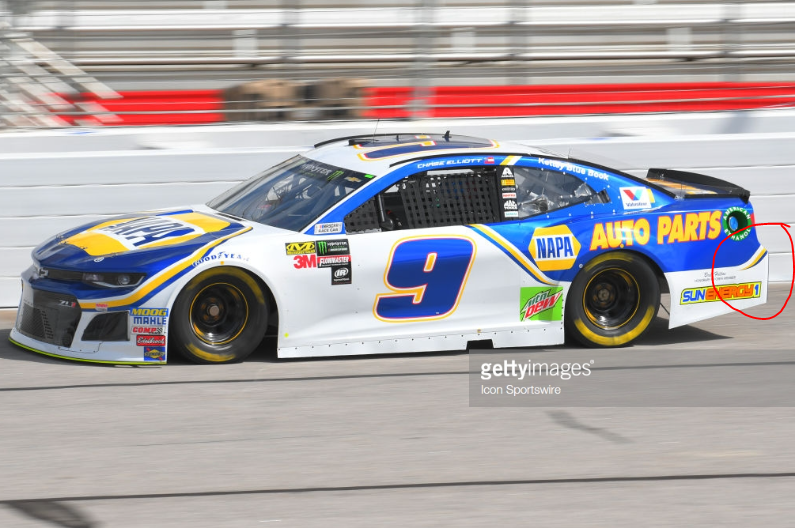

**After further review it looks like their Atlanta car had it too. Minus the caved in window.
This was from Daytona. So yeah, they started doing this as soon as they hit the 1.5ers. Somebody knew about this from the jump. I guess if they had an OSS bay on campus they figured it out on their own.
For comparison, this was the 9 at Atlanta, 2nd race of the season. Behind the curb, also one of the last organizations to have their own OSS bay.
