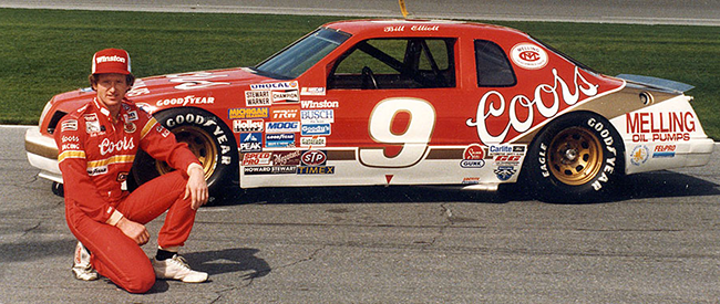

check out that bill elliott car's spoiler I freakin love that. that has got to be a super speedway car! the old timers talk about banging the spoiler down themselves when they were ready to let rip around dega or daytona. heck I think they even adjusted it as an adjustment during the race. also notice the exhaust running out the left side. They actually used to make the exhaust really heavy because it was the lowest part of the car. I know people talk about the good ole days but the leader winning by 2 laps or 3 cars the lead lap would really get people complaining. that is what you would get if you really started to open things up like they did back in the day.

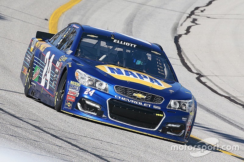

View attachment 21573 View attachment 21574

Yours is a common sentiment among the "garage fantasy" set, who idealize the car, and like to reminisce about the cars that Awesome Bill drove and how his car was similar to one they might have owned... "Yeah, my T-Bird was fast and drove real good. That car had soul, and the chicks loved it too."
Except Nascar hasn't raced production cars since the mid-1960's and Elliott's T-Bird was purpose-built for racing in Dawsonville, GA just the same as his son's Chevrolet is purpose-built in 2016 in Concord, NC.
Meanwhile, all the Racers I have known over the last 45 years have a different sentiment... that the race vehicle is just a tool to get a job done, not a lust object to be worshiped. (I am specifically referring to Racers, not poseurs who dabble at track days or do things like the BMW Performance Driving School - complete with photos and gourmet lunch.) A car or bike is just a tool to get around a race track faster than those other sumb!tches can get around it. The soul it has comes not from how it looks in silhouette. Its soul is the soul of the Racers who built it and raced it.
Yes, I think current Sprint Cup cars are beautiful, and I'm pretty sure that Bill Elliott would as well, if he were a younger man getting ready to strap one on and show the guys how it's done.
Teams build the cars low to the ground to gain speed. Air turbulence under the car creates drag and reduces downforce - which in turn hinders handling / reduces momentum carried through the turns.
Racers don't care much about how the car looks, but NASCAR executives do so they go along with the lowered stance. The execs realize that looks help sell tickets and attract sponsors.
The lowered stance doesn't help much to prevent liftoff if the car spins or wrecks. The act of spinning or wrecking usually causes a car to lift up, and then air can get underneath it yielding liftoff. The only ways to avoid liftoff is to spoil airflow over the car (hence roof flaps etc.) or slow the cars to below liftoff speed (somewhere around 200 mph). The car's shape creates a natural lifting surface (like an airplane wing) but to fix that you'd need the top to be flatter and the bottom to have a downward bulge in the middle; the former would make it even harder for drivers to see out, and the latter plays havoc with suspension movements.
