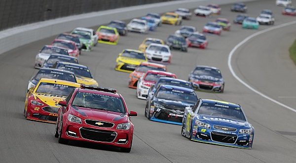

3. Make the cars the same frame dimensions as the street cars, aesthetic designs arent enough. Just look at the real SS vs gen 6 SS. Its almost embarassing.
That's a good point there. A skinnier car may be able to pass a little better too
