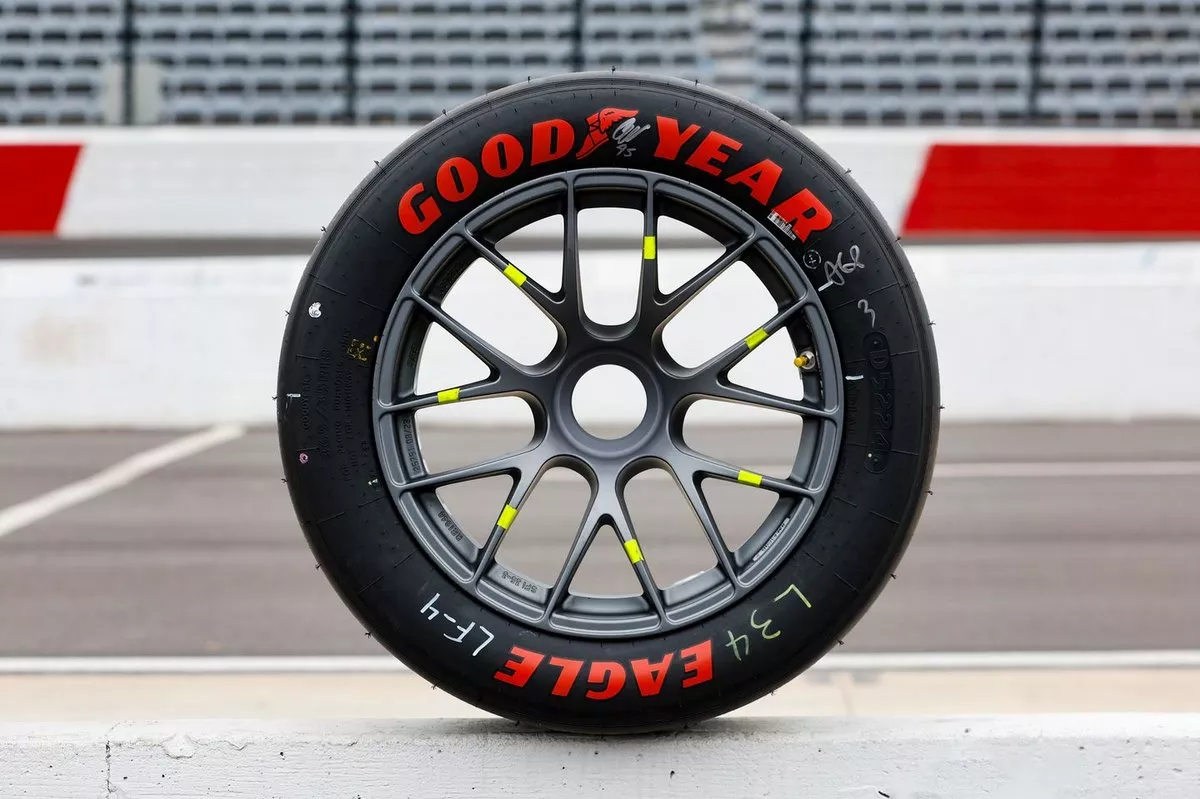

How many race outcomes have been determined by the wheel / tire combination currently in use?
16” wheels, steel or otherwise, won’t clear the NextGen brake package and the current hubs wouldn’t work.
The 12.7" rotors will fit, including the calipers inside a 16" wheel. Hubs are no big deal whether forged or billet the same amount of material, same bearings, same seals will work, just punch out the five positioning stubs and put studs in.
What is the diameter of the “circle” created with the calipers bolted in place? How much clearance would there be between the calipers and the 16” wheels?
The hubs locate the wheels with 6 drive pins, not 5. Loose / errant wheels are caused by human error, not bad design. Just like the moldy old days.
1" clearance between inner rim and furthest extent of the caliper when using a 16" wheel. Twice the recommended distance that the brake manufacture states. Still allows for flex and circulation. Keep in mind, during development of the spec they experimented with five lug, 16" wheels and did not have an issue with them.
But.... since the 16" wheel/tire combo would have still required a "new" tire NASCAR took the stance that if we are going to change, might as well go big change.
Why the 18" BBS wheel? A person I know (fellow engineer) that worked on the development, said there was a lot of lobbying going on.
For some reason, the sporty car crowd has infiltrated the roundy round car crowd and either pushed the old guard out or caught their ear, pushing the tech guys to the left (my own opinion as to what construes "left"). It was not only the IMSA contingent as there was a push from overseas too, why they would have a say is beyond me.
Blaming the crew is myopic and not the root cause. The root cause is wheel attachment. Whether there are six drive pins, twelve drive pins, or whatever, it would be pretty simple for the hub manufacture to drill five holes instead and press in studs.

You are probably correct, but there is precedence for revision of specific mechanical missteps, like the wheel/tire combo. Nascar has in the past corrected aspects that were already paid for. Would not worry about development funds, the 16" five lug was also in the development and did not bring up any issues. Inventory is what it is, the pre NextGen inventories were higher than they are now.
Hard to ignore Goodyear’s investment in the 18’s three years in.
What other classes of cars use them? How much do those cars weigh?
The 18" tires, again, different compounds (due to weight of course, or because they have to run entire races with them) are used in Europe, Australia, South America, etc on sports car circuits. If I am not mistaken, SCCA uses them also. 16" tires are also used in other series, again, the sporty thingies.

Have a technical update. The 18" alloy wheels have the same inside diameter as the 16" steel wheels (within .100") due the thickness of the alloy wheels being 22mm or almost an inch thick.
Do you think 5 lugnuts could work on the current 18" wheels?
They do make 18" five lug wheels, so do not see why not. Unfortunately, the 18" wheels require a tire with a very small height in the cross section so it still will not get the car off the ground. Losing wheels is just one negative of the current system, the other is making the vehicle immobile when they get a flat. One of the biggest positives of roundy round racing is the ability to come back from adversity. Getting a flat in Cup compared to Xfinity is a death knoll for the Cup car, not so much for the Xfinity car.
I agree, it's not a good look when the wheel is so bent or the tire is so shredded they can barely make it back around to pit road. I know NASCAR said five lugnuts on the 18 inchers would be a safety issue, but given how many lose wheels we've seen with the new car, it'd be interesting to see how the standard mounting system would work.
