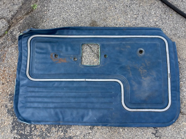

I’ve never done door panel upholstery before. I got this idea in my head.
Original Sport Custom panels are glued to some kind of fiber board. The window channels on this 72 truck are open to the elements and the fiber board gets warped.
I decided to try to make my own.

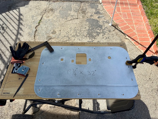

I used 3003 aluminum to replace the fiber board cards. Bought some vinyl, tweed, sew foam, acrylic felt and aluminum square stock.
Original Sport Custom door panel vinyl
3003 Aluminum made from original fiber template

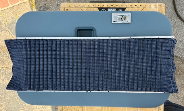

The aluminum square stock will be polished and installed with stainless countersunk screws and will divide the vinyl and tweed. Upholstery dude down the street mated the sew foam and the tweed for me.

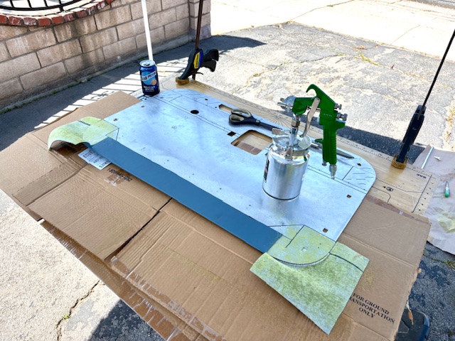

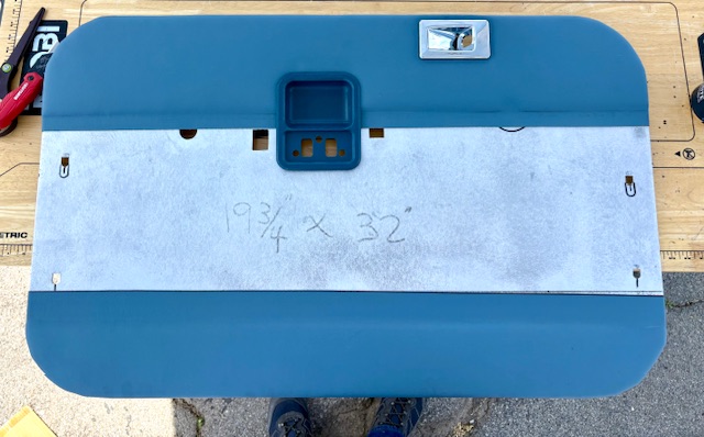

Started gluing this morning

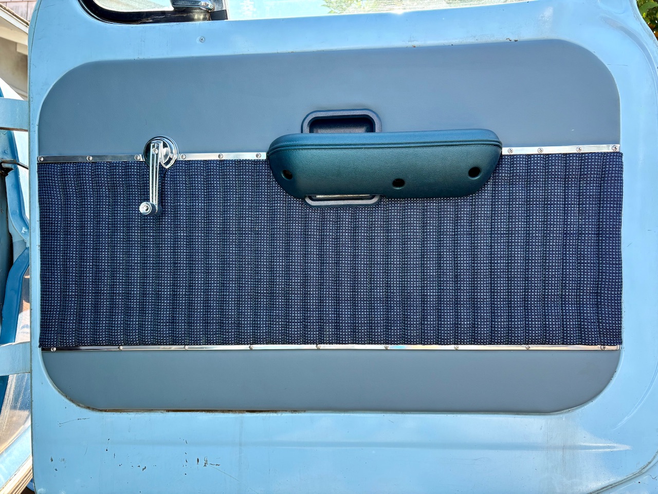

These last two are a mock-up of the installed center tweed panel.
