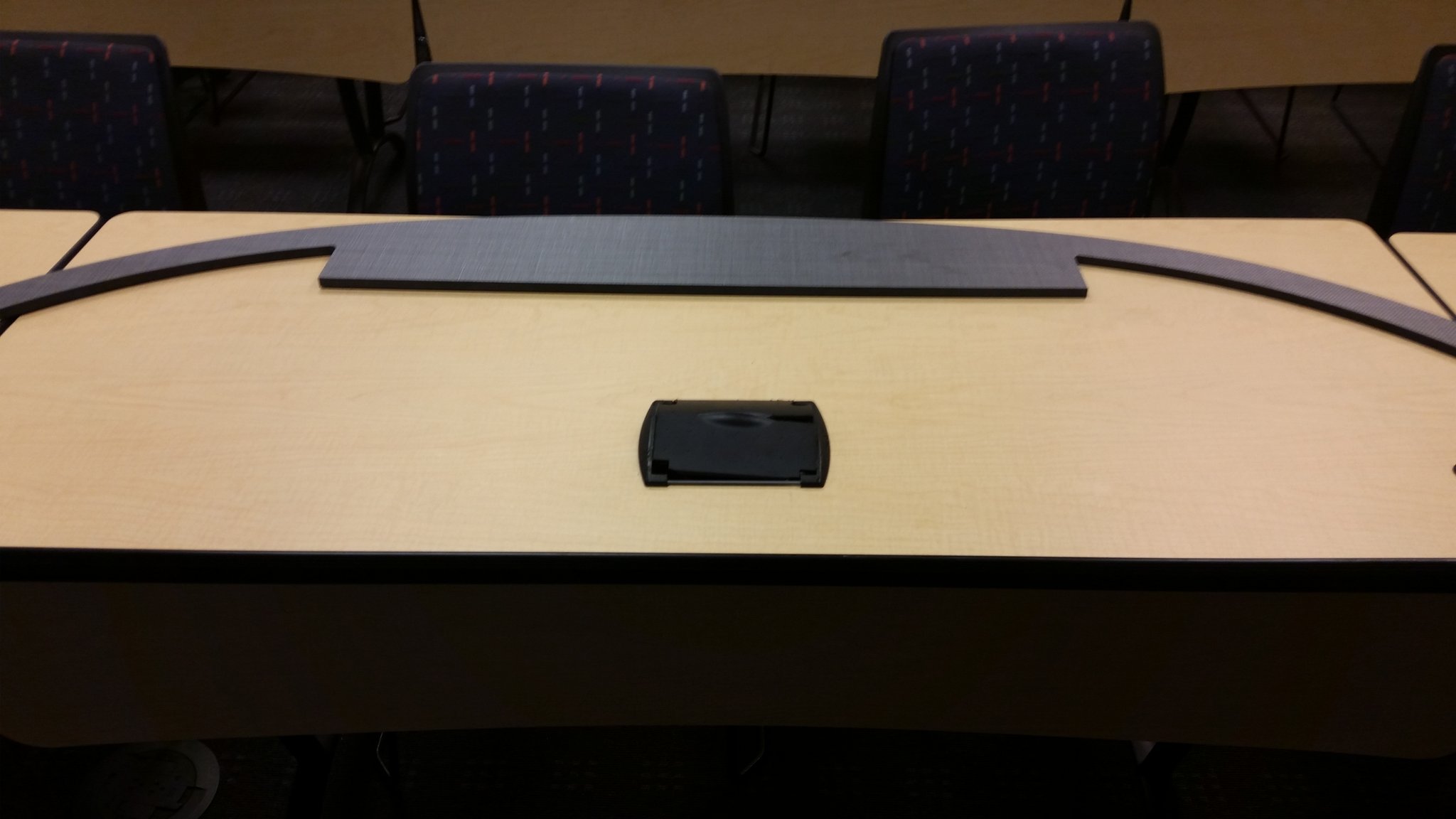

The leading edge is already 0.25 inches, so they'll be shortening the extension panel that isn't visible, correct?
CjY44VIWgAEIHyQ.jpg:large
Jeff Gluck (USA Today) offers tantalizing numbers on the targeted downforce reduction: 2700 - 900 +100 - 500 = 1400
