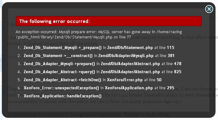

What are the odds? Just as I post this into this thread I got the attached error.....

There was a delay after pressing the 'Post Reply' button on the above post followed by that pop up. Maybe that was something on my end? IDK. I'm not that computer savvy.
I had posted into another thread a few minutes before this without error.

My first post today.NFL week 9 thread and got this error message then it doubled the post?
An exception occurred: Mysqli prepare error: MySQL server has gone away in /home/racing/public_html/library/Zend/Db/Statement/Mysqli.php on line 77
  1. Zend_Db_Statement_Mysqli->_prepare() in Zend/Db/Statement.php at line 115
  2. Zend_Db_Statement->__construct() in Zend/Db/Adapter/Mysqli.php at line 381
  3. Zend_Db_Adapter_Mysqli->prepare() in Zend/Db/Adapter/Abstract.php at line 478
  4. Zend_Db_Adapter_Abstract->query() in Zend/Db/Adapter/Abstract.php at line 825
  5. Zend_Db_Adapter_Abstract->fetchOne() in XenForo/Error.php at line 50
  6. XenForo_Error::unexpectedException() in XenForo/Application.php at line 295
  7. XenForo_Application::handleException()
then tttt
I will see if I can get a Tapatalk developer to come look at this setup specifically. They seem to be experiencing no issues with 1.2.1 when they tried to replicate it.
Line 115 is fine, if it weren't then things would be way more broke than they are now :p..something about Tapatalk 1.2.1 is interacting badly with this forum, and I've seen it happen at one other site before, who also had to downgrade to 1.1.4 to get rid of the problems. My guess is it has to do with the push notification support that came with 1.2.x. If you're replying to a thread that somebody with Tapatalk has subscribed to, it sends them a push notification to their device. To send out a push notification, I'm guessing it has to contact Tapatalk's server to let them know, and if that takes some time, well, our MySQL server here doesn't wait around forever for the PHP script to finish up, so that's where the database error comes in.
