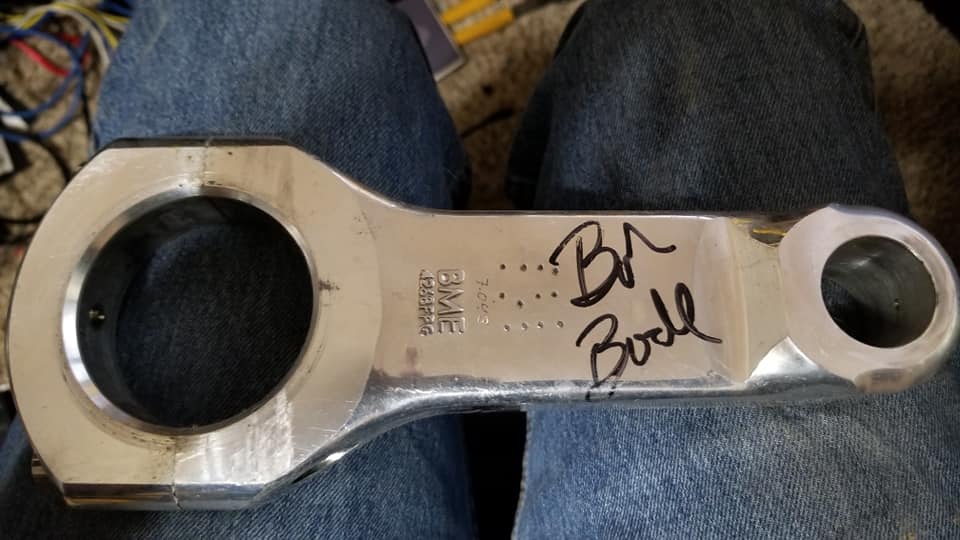

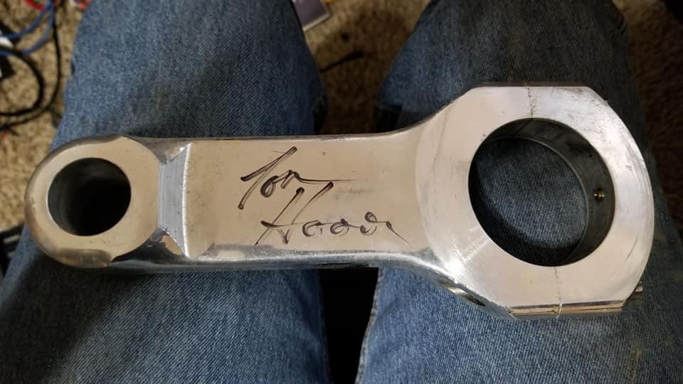

@Nitro Dude can you date this rod?
It's from a box that I haven't opened since 2014 (trying to clean up the house). I don't know when Bob and Tom would have been in the same place. I was thinking maybe the CHRR when it came around to Noble, Oklahoma many many years ago (2000ish?), but I thought it was all altereds, I don't remember there being any funny cars. I don't think it's from when I saw ya'll at the Pomona world finals a handful of years ago, but that's a possibility. That was world finals 2013, right before we moved. Was Tom there for that race?

I can see that the rod out of Bodes engine was put into service on 7/04/2013 and it has 12 runs on it and the video of us warming up was at the World Finals in Pomona Ca in 2013. My guess is that you got that rod at the Finals in 2013. Tom has a house in Minnesota and Florida so he usually comes to Brainerd, Gainesville, Indy, and sometimes Pomona.

I would NOT have even thought to decode a date from that scribe. I showed it to Hale and he explained the dimples to me.

One run per dimple? I'm loving this thread..
"Hey nitro, remind me where I acquired this rod" lmao.

Yes they put a dimple for each run. They keep track of how many runs are on just about every moving part... rods, crank shaft and hub bolt, input shaft and coupler, tires, rear end, blower belt, mags and coils, rockers, push rods and shafts, valves and valve springs, headers, cannon and reverser, even the motor plate has to be checked to make sure it doesn't warp.:)
