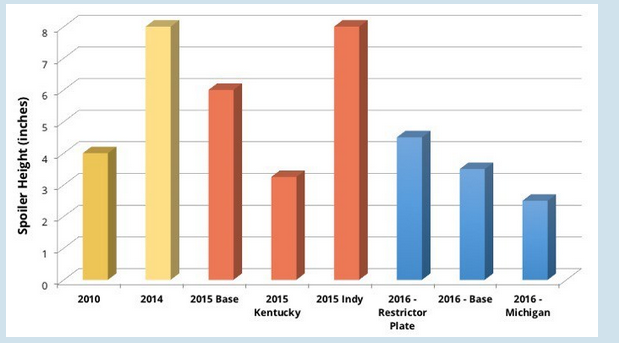

http://buildingspeed.org/blog/2016/...cks-problem-how-much-downforce-is-just-right/

I can argue the racing hasn't changed very much with high or low D/F speeds are essentially they same. The laps led with is a rough measure of passes for the lead are again basically the same. There is no blinding speed gained with this latest low downforce package or super human driver skill. It is get out front by hook or crook.
This will probably be shu shued, I don't care but the data doesn't lie. The racing isn't reallythat much different as some would lead everybody to believe. I'm not saying it is bad or horrible racing. The biggest change I see lately besides the VHT stick um is the TV coverage. Recently, the cameras are searching everywhere to show cars passing, sometimes focusing on back packers while their is a rare pass for the lead.
