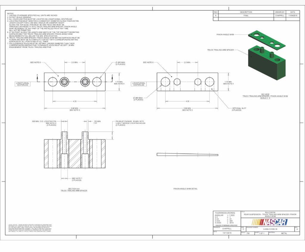

I'm confused because the penalty report refers to not having planar mating surfaces that maintain full contact at all times. There was no mention of degrees of skew measured. The illegal non-planar surfaces are discovered by teardown, not by laser measurement. At least that is what I think it means.
The non-planar pieces are intended to create skew under cornering loads, but return to alignment when static. These parts are illegal per se. But pre-race inspection will not find the parts, unless it is disassembled.
I'd guess it was visually obvious post-race and not so before that.

DJOeAMpW0AAi1iN.jpg:large
Jeff Gluck‏Verified account @jeff_gluck 33m33 minutes ago
Happening now: NASCAR informing teams that it will strengthen penalty for this infraction that keeps popping up.
NASCAR has noticed a trend, so the penalty will be raised to stronger punishment (40 points, $75k fine, three-race suspension for CC).
they need an assembly drawing to go with that. That doesn't really show the problem in relation to the other parts involved. That is a manufacturing drawing of a part. they probably don't have one, but something like this would show the problem
