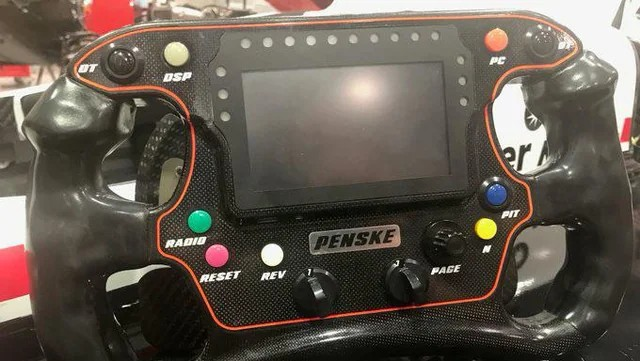

The two videos of sequence of buttons being pushed.
urules
6h ago
This may have just opened up a big can of worms. If you look closely they push DSP (display) once followed by OT (P2P) and then quickly select DSP again.
iquidDiviums
6h ago
Not only that, but the normal push-to-pass activation LED’s and display indicators are suspiciously absent.
urules
6h ago
iquidDiviums
6h ago
Kevin Lee said on the radio this evening that Penske have had the wheels programmed not to display green LED lights when using P2P - legally or illegally - for a little bit now, so that other teams can’t see on the live broadcast and tell their drivers. But the button pushes are suspicious.
