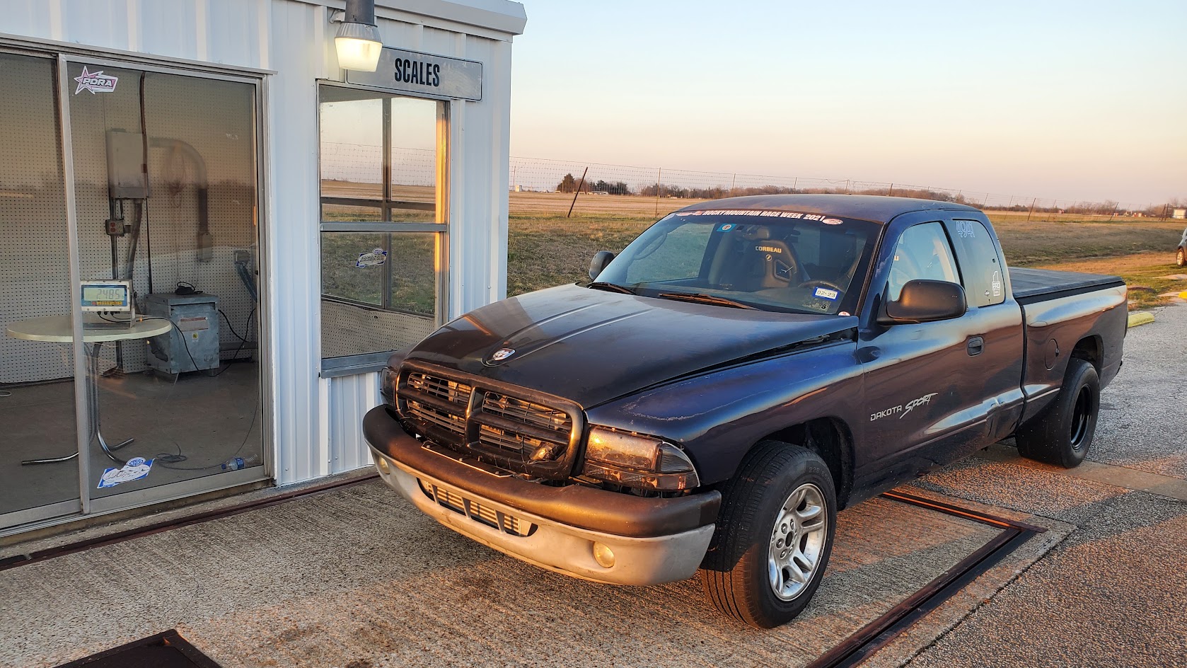

Took the Dakota to the track this weekend. It was bitter cold and wet - 62 degrees ambient, 75% humidity (incidentally, 75 grains), 1700 feet DA.
The gear change made a huge difference. Not sure if the converter change did anything at all.
Taking these 6 year old DOT radials off and putting a 28x9 slick on. Gonna try to go back out December 4th, weather permitting.
Even on the crappy old tires, it's lifting the left front tire off the ground for just a moment. But initial traction isn't happening. Hopefully the slicks fix that.
Also need to adjust the traction bars significantly.
Best pass was 7.32 (previous 7.67)

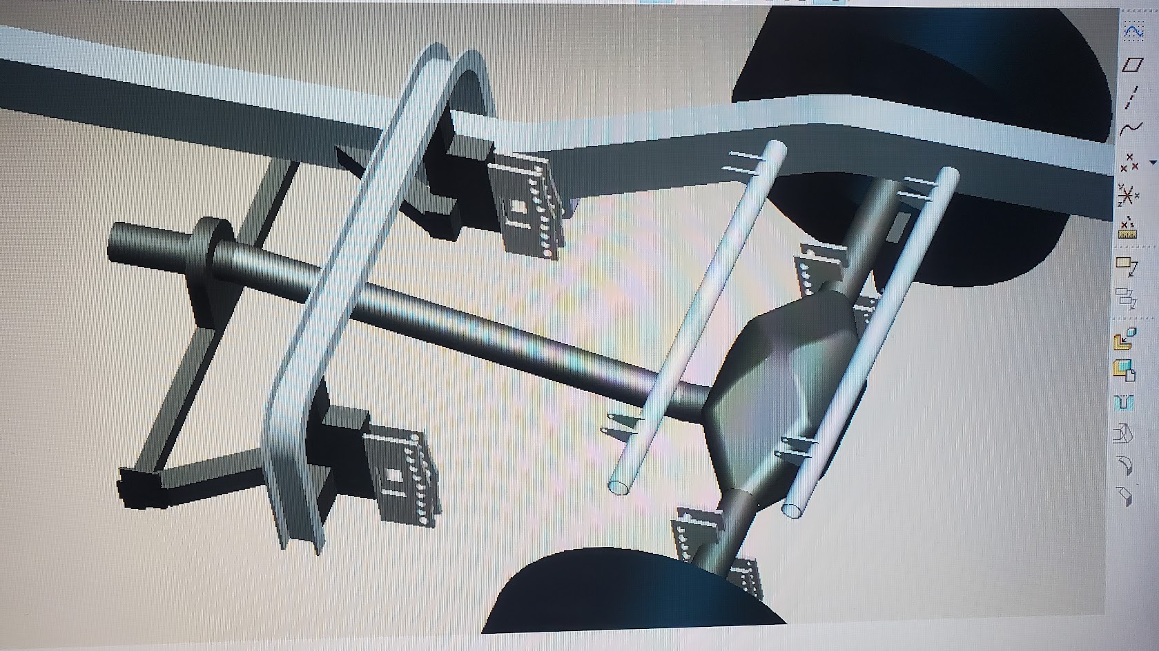

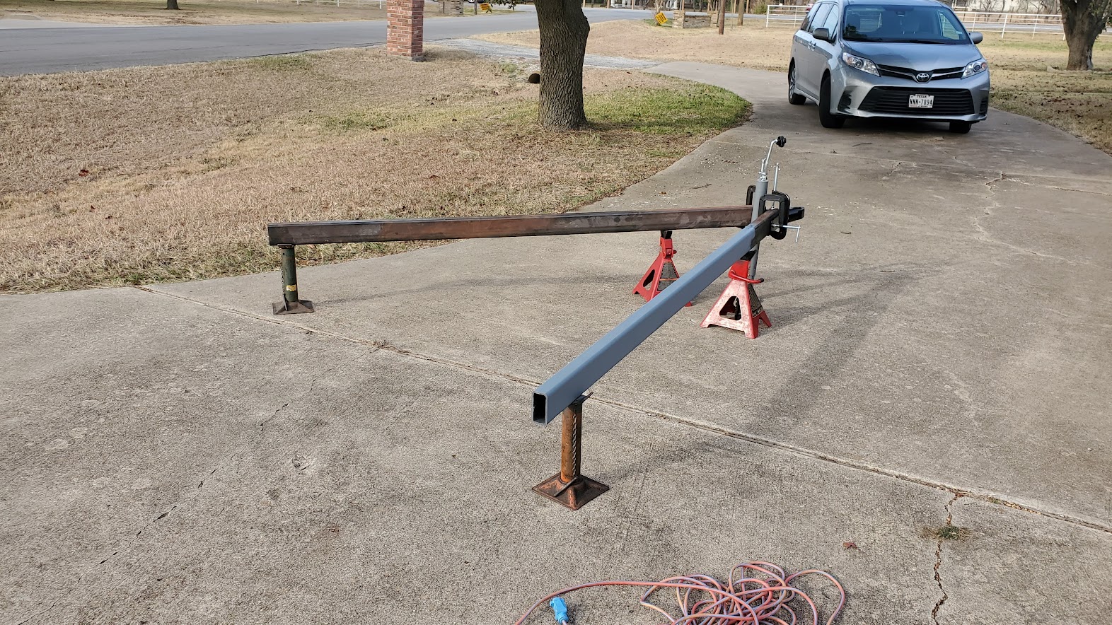

Been crawling around under the truck this week. Got the front driveshaft loop all done and driveshaft back in.
Figured out how to run the battery cables for the combined adding a battery & moving the existing battery. Also looked at my anchoring options.
I have a general idea for where to put the methanol injection pump, on the carrier bearing crossmember. Going to put the tank over/in front of the left rear fender.
As much as I really want the air compressor to be behind the axle, I am not sure it will be feasible. I found out the Viair compressors are not rated for "wet duty", so I am apprehensive to put it under the right rear bed corner like I was going to. I'd have to make a pretty big shield to keep it from getting coated in debris and spray. The entire back of the truck already has a layer of burnout rubber. It's also supposed to be mounted upright and in a well ventilated place.
My second thought was to mount it to the shock crossmember, but there's not really enough room for that without adding alot of structure.
So i may just put the compressor and tank where the battery is now. The compressor is 11 pounds, figure the tank is 4, call it 15 total. The battery is 38 pounds. So I'll still be adding 38 pounds to the left rear and moving 23 pounds behind the right rear. I can put both up high and leave the bed clear for putting supplies under. Also have to remember that I'll likely have roll cage bars going through the front of the bed, too.

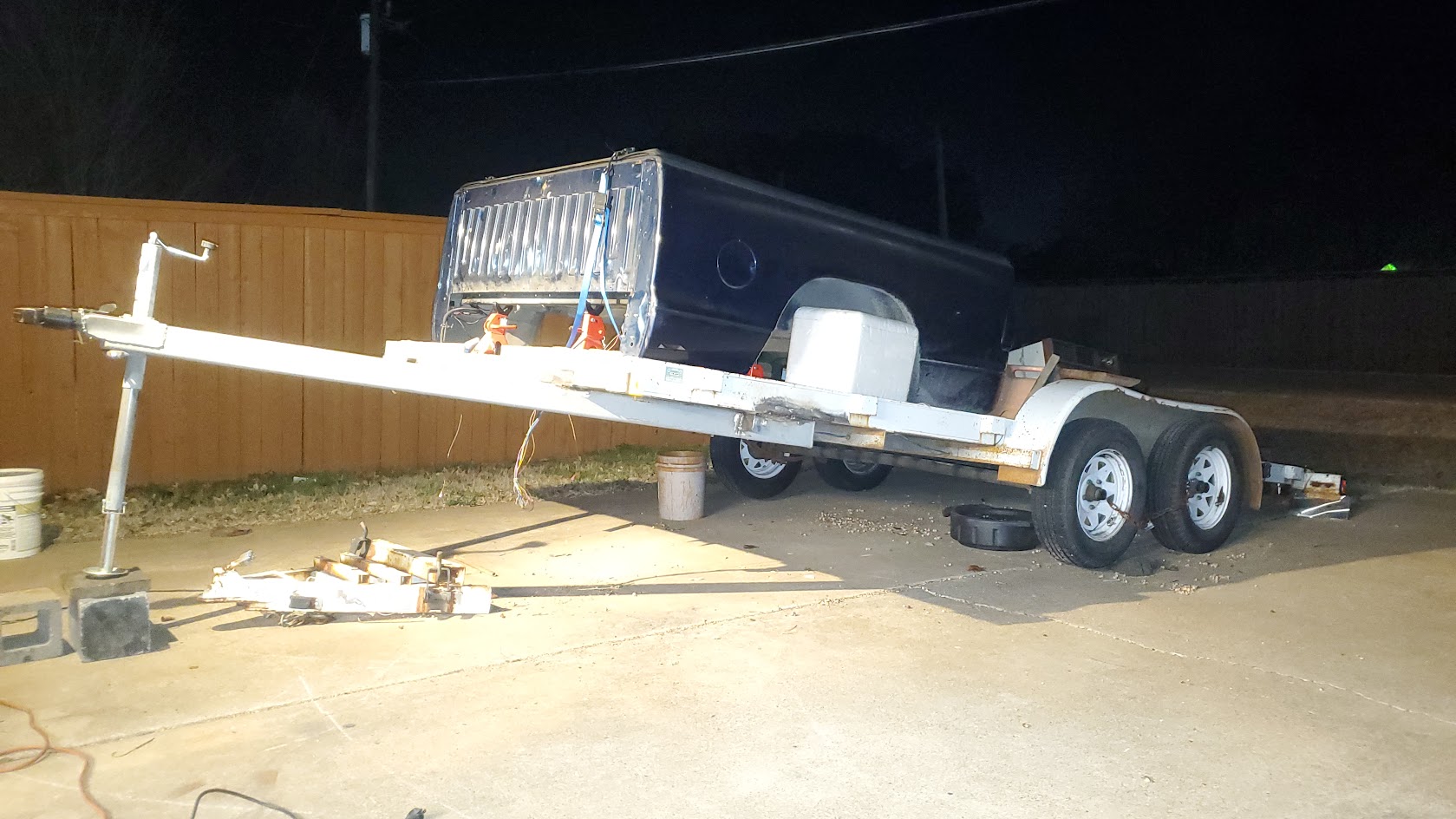

In the meantime, I've also been working on the new tongue for the 16ft flatbed trailer. It's not a big priority as long as the coupler on it now doesn't come apart.
https://photos.app.goo.gl/r4wgLwDGEVHk8Ly16
AM-JKLU06vHEjmiRNXQX__uhBoW1riz-9-lZXRFCJiPKglp-TQenbxL_Lvhs0ngT-s9Yuxbi7OQ17CmyLfrVOBSK7xhW5fzCTwST21-bRp9N3hcD7RFF9ohzmt9syQdY7aF_a-_01aisD01OnXGoNbGf9-ZjvA=w1296-h884-no
https://photos.app.goo.gl/6qZMAgopMrVTCGwF7
AM-JKLUihS5Ne8B2BDnlCvpUt0tLrm3JFWS6R2Y20rPh8EXvOh5oLtkEawavZfwoU5trwd_fO6vYrIL8IsbTw6bcawN3zocZNOgD1GRLVzjHBc9M9_YvKShshZrIrtJBKp_XCbcitf1Cb9Cus1l2CGXKBWDEQg=w1572-h884-no
https://photos.app.goo.gl/5bvHRT8iKGuWgEFc6
AM-JKLWZ8p5IEvOLMYqnaxC6sjInKjm2-e3bsqsP37HSZpnc7mb5kATtUXZlHYLrc5rwVYurLvbljpzzWNPMUssos3UGWv3o44lDZRFyo4WX5ymlu7nhp6jtV0OO6Zjdlyjcahbqreqn9pUR8zKyQENynPNnIw=w1572-h884-no
https://photos.app.goo.gl/RTiQGedY56a4MNwc9
AM-JKLVWf3ZWMLodtI7uCQQZKlvrgV5tXpvjuN5rAPYB1v96VzgnlmH4bq-AK-r5kgAIeHmNik90iF9NiwRZ7_OzzsdDjgx2uYhyG8Pt52pSsNpEZdB4VRfyzCT4PtOwlMPucBx_9AdGNKYZTIpgeq3MB2NImw=w1572-h884-no
https://photos.app.goo.gl/B5oVQzQynL9Gp75r8
AM-JKLWrDV4XwofWYD28H98eTA4Tn39OgiImqRFo3ue8Fg6L0Yx-CEk2xoFd4a1YKM-ZYbBBDHjdfaBVysUa-IJHsFCawCIFpP3XWlA5h-Oof8pwj07XSXgH1ymv2AruAmCQcrgEM-qYokU_wW7XbBSVApLJCg=w498-h884-no
https://photos.app.goo.gl/1zrWEeusTHoGnutR9
AM-JKLWfHy7ykhXk2c_7DFRyongvFuqFiaHf9UkifkePYBHVlQvpDcCCtJ-mtx8nL5EBhZro8IuREUNqZJxCU6JpI7wSOQN6ZeUwjZ-iSpvROYdHL3V5JPQyRYPaH-R8RigL-hU9cBIRrsuKwuV9Hc1bA4LxDg=w498-h884-no
https://photos.app.goo.gl/nPMENaAGgAEkh6YUA
AM-JKLU4ArubewQqDMfPeBihbLKAAHcGMtH2CqDGyQlA2XhWpTdmztHxscVyyYYiefyDxBSyCnuJ6Ksp5qM3W670IEzsI6fN-q0xnuG-_2rwy2uWfWzIDjqgMBk0L9rLUyFWNCbZeje-5ccK5kpSfMVNkK0LZA=w498-h884-no
https://photos.app.goo.gl/screqyxEQQzRZtBs8
AM-JKLVBDaAVc6KB42lnBm5rgLJPJeRkhvrrQb5KDZpzvjOkF-XNq0PXCQWN89X_-SLHwOe6PZGhoewHmC-t1KlKNr-jMld4c3DIfRuHxTIr2ux-9X18u5S81SffgaoKWN0ENilpPjSpdf6dGjx7gykiw-OKEQ=w1572-h884-no

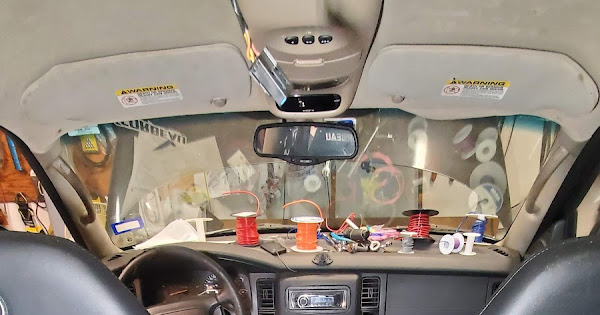

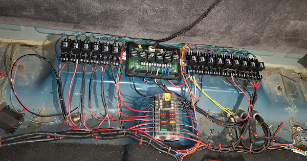

That's 9 straight weeks of either working on a friend's barndominium, working on the race truck, working on products/projects I'm building, or with the Girlfriend. Most days I nap from 2:30 or 3AM to 7AM anymore. I'm "working" well over 120 hours a week.
I've stripped the interior aside of the dash, removed all my wiring, and started over from scratch with all new relay panels and layout. I designed and assembled the new relay panels myself.
The seats were a fiasco, I had to raise them up an inch and move them inboard an inch. Finished the passenger seat last night.
Today I got the shifter mounted. I'm ditching the electric shift and going back to traditional cable. Hoping to weld the cable bracket on Saturday; going to the barndominium on Sunday.
Tomorrow I hope to finish the battery isolator. If I'm lucky, I might make some headway on the switch panel.

Completed Rocky Mountain Race Week. Finished 17th out of 50 in the 12.0 index class. Went 11.96 once, 11.95 once, but couldn't claim those runs and had to backpedal for legal runs. Won first round of the bracket race but it cost me 3 ribs of the blower belt; Lost second round in a close race. AC worked great, had no mechanical issues. Upon return, found a fuel leak in the filling hose (probably loose hose clamp). I need to add a catch-can to the transmission vent; it's tossing fluid when hot. So i ordered one of those from Summit with my new blower belt. I also paid the penalty for a shorter belt. I've been running a 5120788 ($40 at summit; 78.74 inches) and switched to a 5120783 ($47 at summit; 78.3 inches). I don't think the 1/2" will do much, but it might keep the belt from hitting the tensioner base. I'm also going to feed that part of the tensioner base to the dremel and angle grinder/flap disk to smooth it out.
Signed up for King Of The Open Road this morning. It's a different, 2-day format with heads-up racing instead of running against the clock.

Been doing some measuring. My numbers show that:
The leaf springs are 40.75 inside-inside, 45.75 outside-outside, 43.25 on center
The pinion is 2.25" offset to the passenger side
The WMS-WMS is 64.5 inches. Factory wheel is 5.5" backspace. Since most race wheels are 3.75-4.00 backspace, the desired WMS will be 61.5 inches to keep the track width the same, and also keep the tires from rubbing the leaf springs.
Along with, I'll be doing the 5-lug conversion to the 03/04 front brakes. the brake rotor is the easy part (I might have found something to make it even easier), but I'll have to get the hubs plugged and re-drilled on 2 of the holes. Hopefully not a huge deal. I have 2 friends with machine-shop equipment whose talents I won't count out.
One issue I have found is that because the 03/04 brakes will not clear a 15" wheel, I am automatically restricted in the wheel designs available for the 5x45 pattern in a 16x8 wheel.
942681242 - Black Rock Series 942 Type D Matte Black Wheels > Wheel, Series 942 Type D, 16 in. x 8 in., Steel, Matte Black, 5 x 4.5 in. Bolt Circle, 4.25 in. Backspace - $98.50 (Six 16x8's for street tires + race fronts)
942511240 - Black Rock Series 942 Type D Matte Black Wheels > Wheel, Black Rock Series 942, 15 x 10 in., Steel, Black, 4 in. Backspacing, 5 x 4.50 in. Bolt Circle, Each - $100.50 (Four 15x10's for race tires)
The JEGS Baja-8 wheels don't come as a 16x8 with 5x4.5 pattern for the road tires; The Cragar Soft 8's come as a 16x8 with 5x4.5 pattern, but with a 5" backspace - would require spacers from a race wheel (std 4" backspace).
