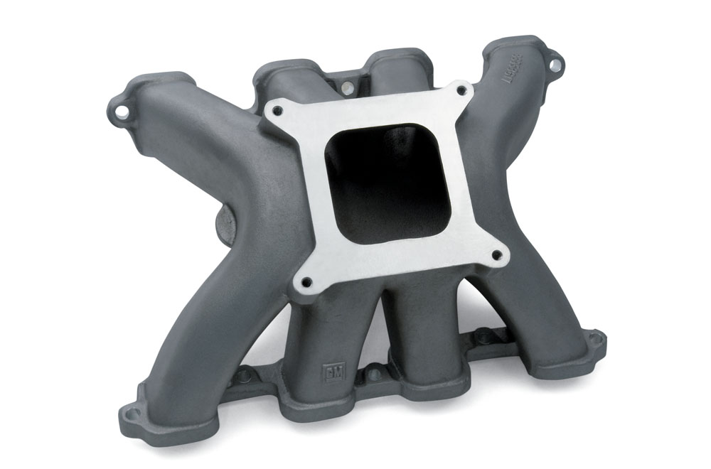

You may find that the SB2 with it's large volume intake runners makes it difficult to get up to speed on restarts. They are great for top end horsepower but a little boggy out of the hole. Once the power & torque come in it's easy to blow the tires off. We struggled with the "big headed" motors in our modified for a year or two using some old NASCAR stuff and finally went to a Mullins and it made all the difference in the world. Good luck
The original SB2 used the same standard configuration small block engine block as was used on the 23 degree and 18 degree NASCAR engines, and used a weird offset valvetrain setup to accommodate the location of the valves in the SB2 cylinder head. The SB2.2 introduced a new block specially configured to more perfectly match the cylinder heads. The lifter bore locations were relocated, and I BELIEVE that the Chevy supplied blocks came with the larger cam bore opening to accommodate the larger diameter camshaft core and set up for the roller cam bearings. Previously the engine builders had to do all that work themselves.

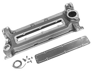

I also BELIEVE that the SB 2.2 came from Chevy already configured for the separate valley tray, meaning that unlike the classic SBC, the intake spider was just that, and didn't seal the top of the block, carry any coolant or contain the distributor. I'm hazy on the details now, but I know there were other ongoing improvements that went into the SB2.2 block. One of the goals that Chevy pursued was to try to supply blocks and heads that required less reworking by the engine builders to get them in race ready condition. The SB2.2 started that, and the R07 carried that on. The R07 incorporated thing like piston coolers in the design so the engine builders didn't have to, and reduced the number of external water lines and such. The actually castings also come much closer to final configuration, and less metal has to be removed.

From what I kind find GM didn't produce an Aluminum SB2 block. So everything in/on this engine is likely aftermarket. Looks like SB2.2 to me?
I have to admit that I didn't even realize that GM was still offering parts for these engines. I thought everything that was out there was just leftover NASCAR stuff and maybe a small amount of aftermarket stuff. You are correct that GM never offered an aluminum block, because the engine was strictly marketed as a NASCAR engine, and aluminum blocks are not allowed.
I know at the time these engines were on the market, a FEW sportsman drag racers were using them, but basically they either had to make the NASCAR parts work for them, or build their own stuff. I also know a few people that had less radical camshafts ground for them and made hot rod engines out of them, but from I saw, even used, the parts were terribly expensive. In an era when you can make 800 naturally aspirated horsepower on pump gas with a LS based engine, I'm surprised people are still trying to make this old iron work.
