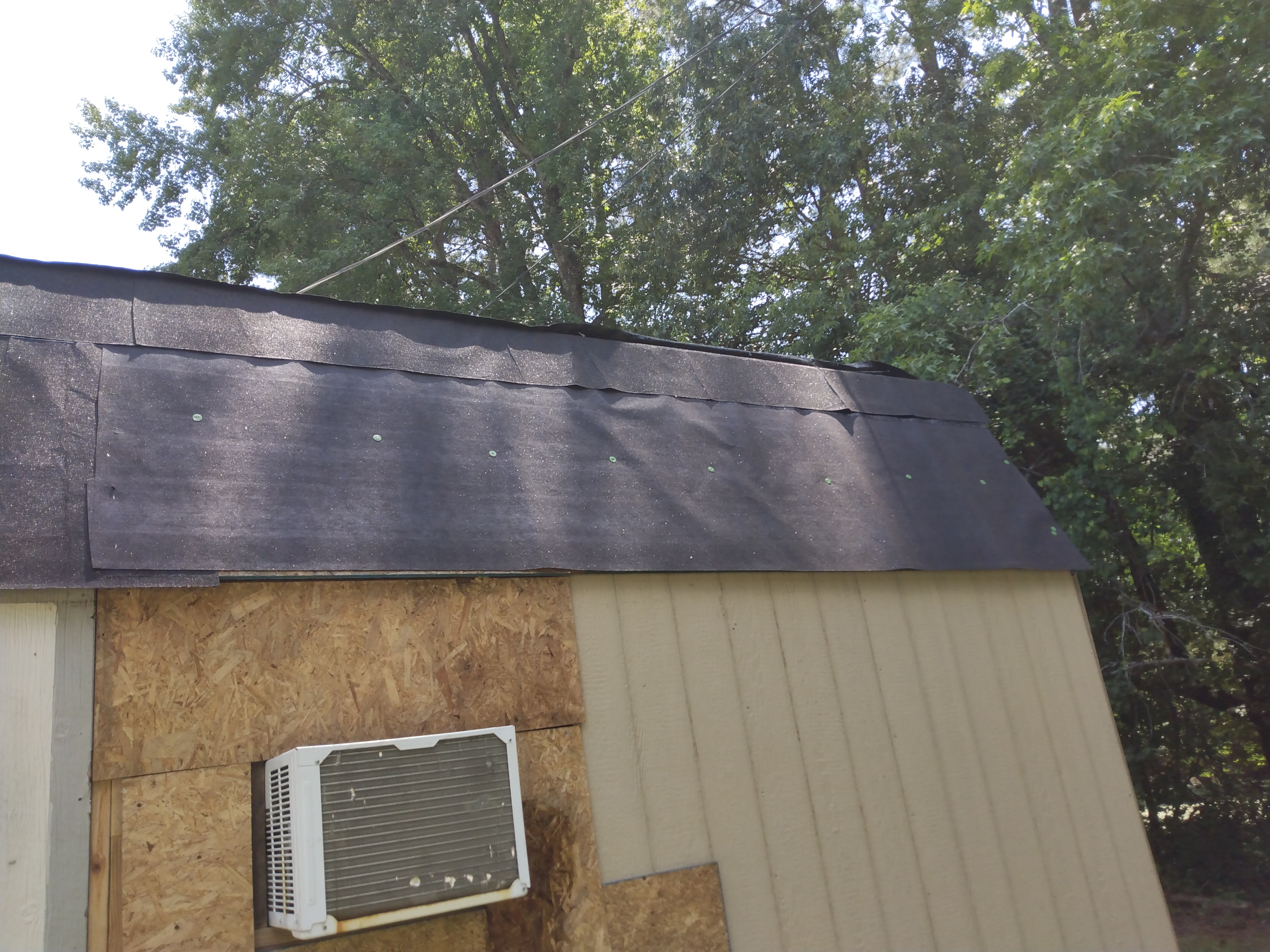

Before and after. Guess was shooting off the nearly flat porch roof.

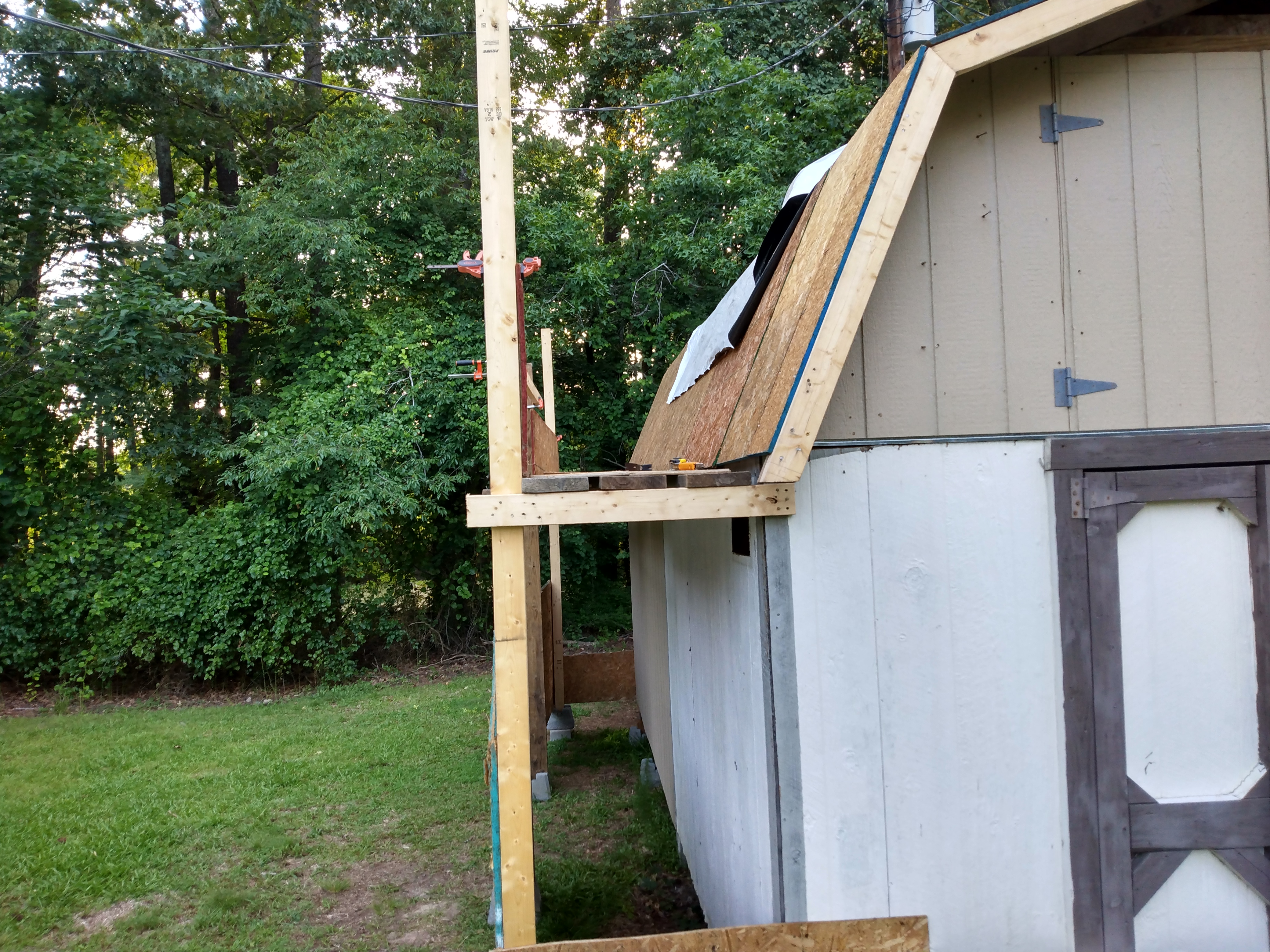

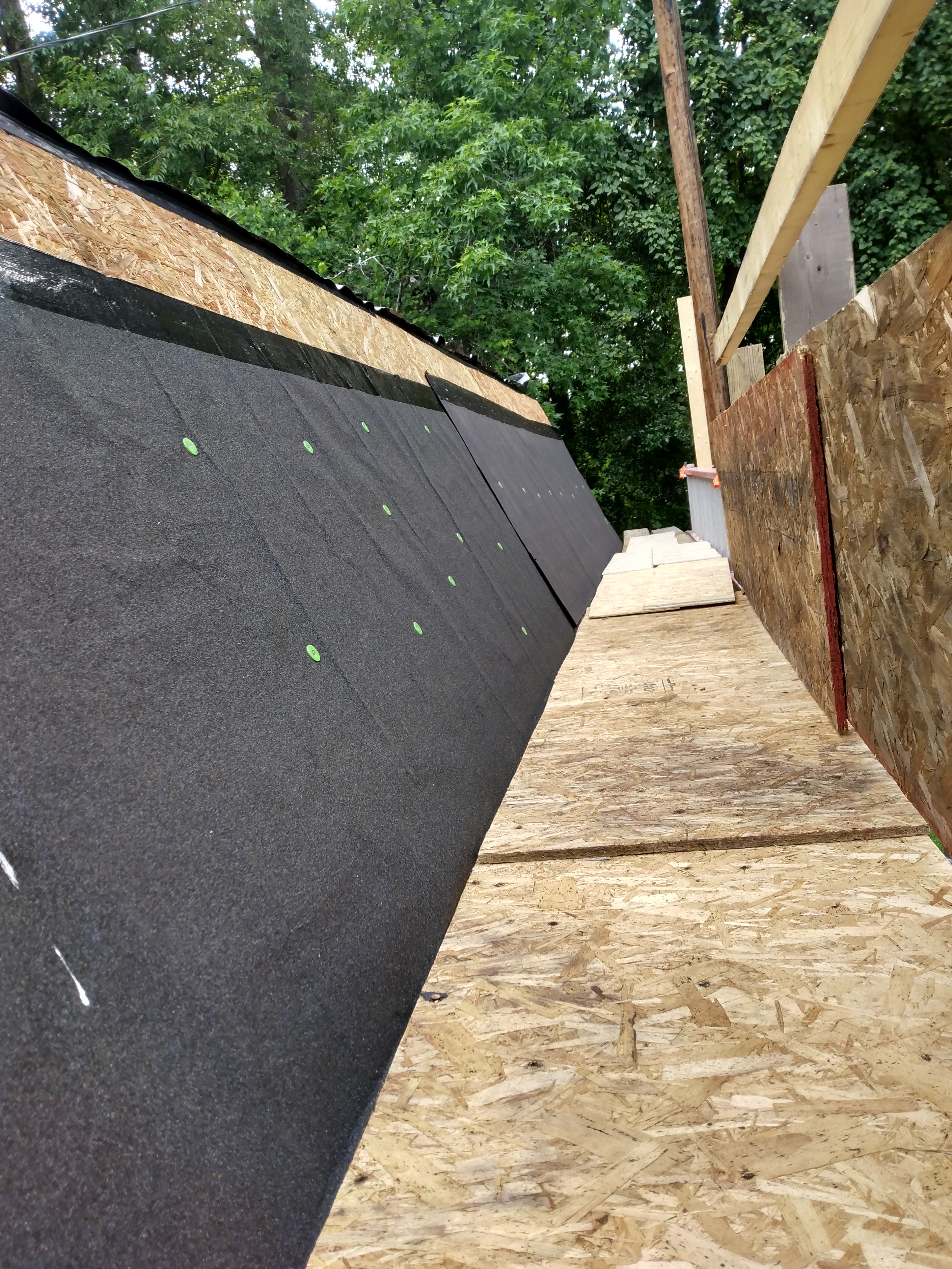

Cut some OSB for guardrail and to lay on the work surface planks so tools don't drop thru. Pulled the run of underlayment loose for about half it's length and reset it to take the wrinkles out. Actually stood up couple times! Ran 2 inch butyl tape run down the OSB seam/gap on one side. Need to go back out and put three runs of underlayment on that side now. Added some cap nails to the one that's on as just too steep for the sticky stuff & staples to hold it. Get it run up/over the peak will put drip edge on. That will help hold the ends.
Tempted to do the whole shingle job on this side so don't have to move the scaffolding 3-4 times. Plus getting shingles on will keep the underlayment from sliding off.
It's a 24 inch wide hallway and I still hate standing up in it. Got one more piece on. Slightly different style. Now I know, especially for this type roof, 30wt tar paper. It will be easier/work better on the top section I think. Mainly it's a two person job on the lower part. That last piece went fine I just don't have the patience for this ****. Maybe go back out and try to get the upper part ran?😵‍💫😵‍💫😵‍💫

Have underlayment run up to about foot from peak on this side. Tacked the plastic down but realized need to go pop it loose and shift it about foot toward other side. That will cover all the gaps. This way can leave scaffolding where it is, do shingles on this side. I'll move the plastic but shingles won't happen in next week as gonna get brutally hot. It's crazy how hot the underlayment gets in 15 minutes in the sun.

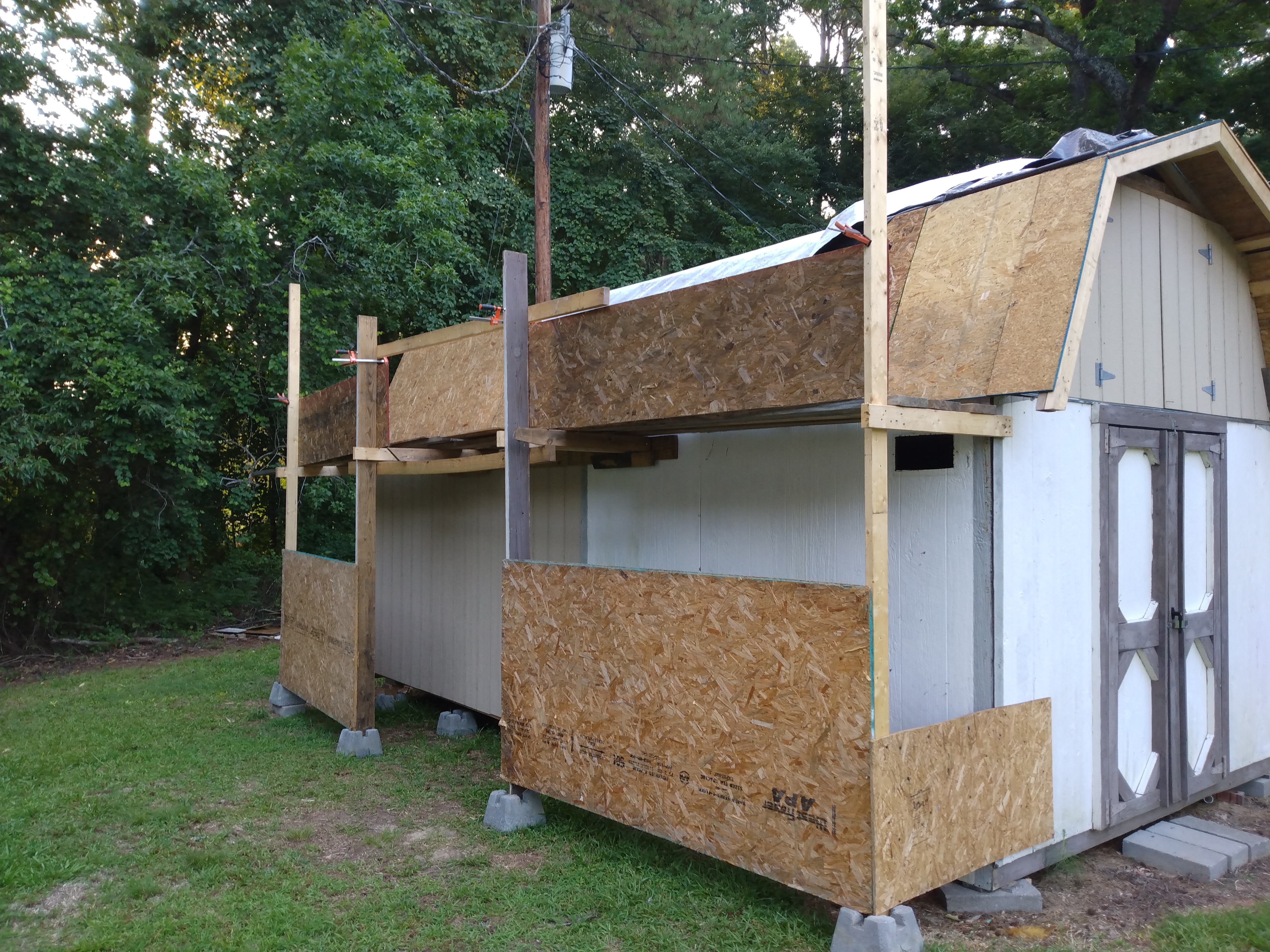

Need to establish scaffolding at front doors so can finish siding and better framing support for overhang. Then can put drip edge on and start shingling. My really cheap 16 foot extension ladder gets too spongy above 10 foot high. It'a about a death trap IMO. Maybe tomorrow.
Scaffolding about 80% complete on other side. Just need to put few screws in the work surface, mount three pieces of handrail. Then...no excuses. Tempted to screw a step I built out of 2x8 & 2x6 to upper part of the steep section to put the roll of underlayment on. Really like to get it run all the way over the top so can remove the plastic that's up there. May end up buying the restraint system again first of the month. Like to put a permanent D-Ring anchor on the peak for any future work.

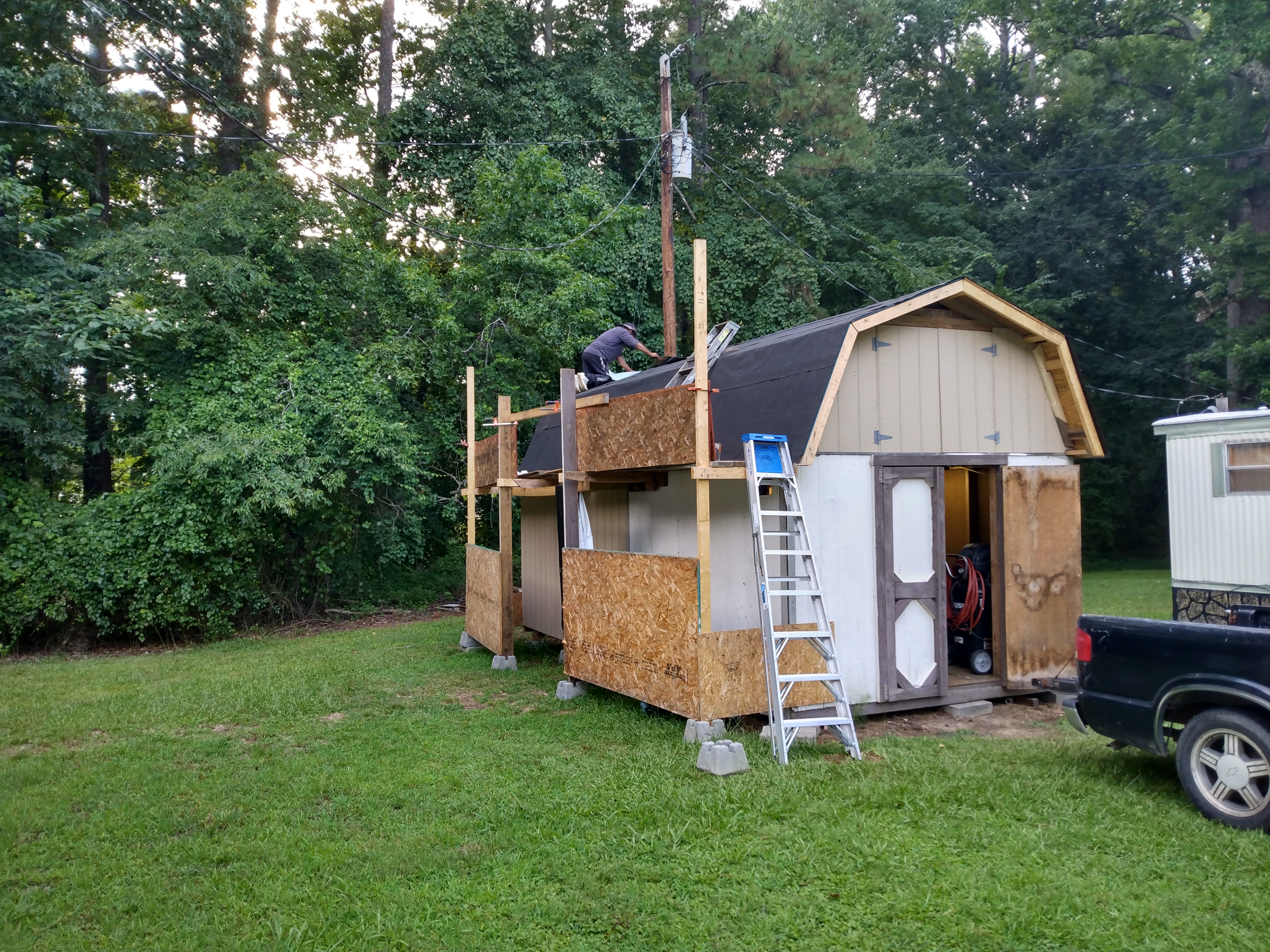

Scaffolding is as ready as I can make it. Tomorrow morning get the underlayment on. Was little hot for it today. At one point the weather thing on desktop said 99 degrees with 105 index. That's hawt!😵‍💫😵‍💫😵‍💫

It be sliding off. Will have to roll the upper section up out of the way if not stuck too bad and cap nail the crap out of it over full length. Not a big surprise. Worst case, just nail it as is, slit the bulges to let it settle and cover with few new sections.

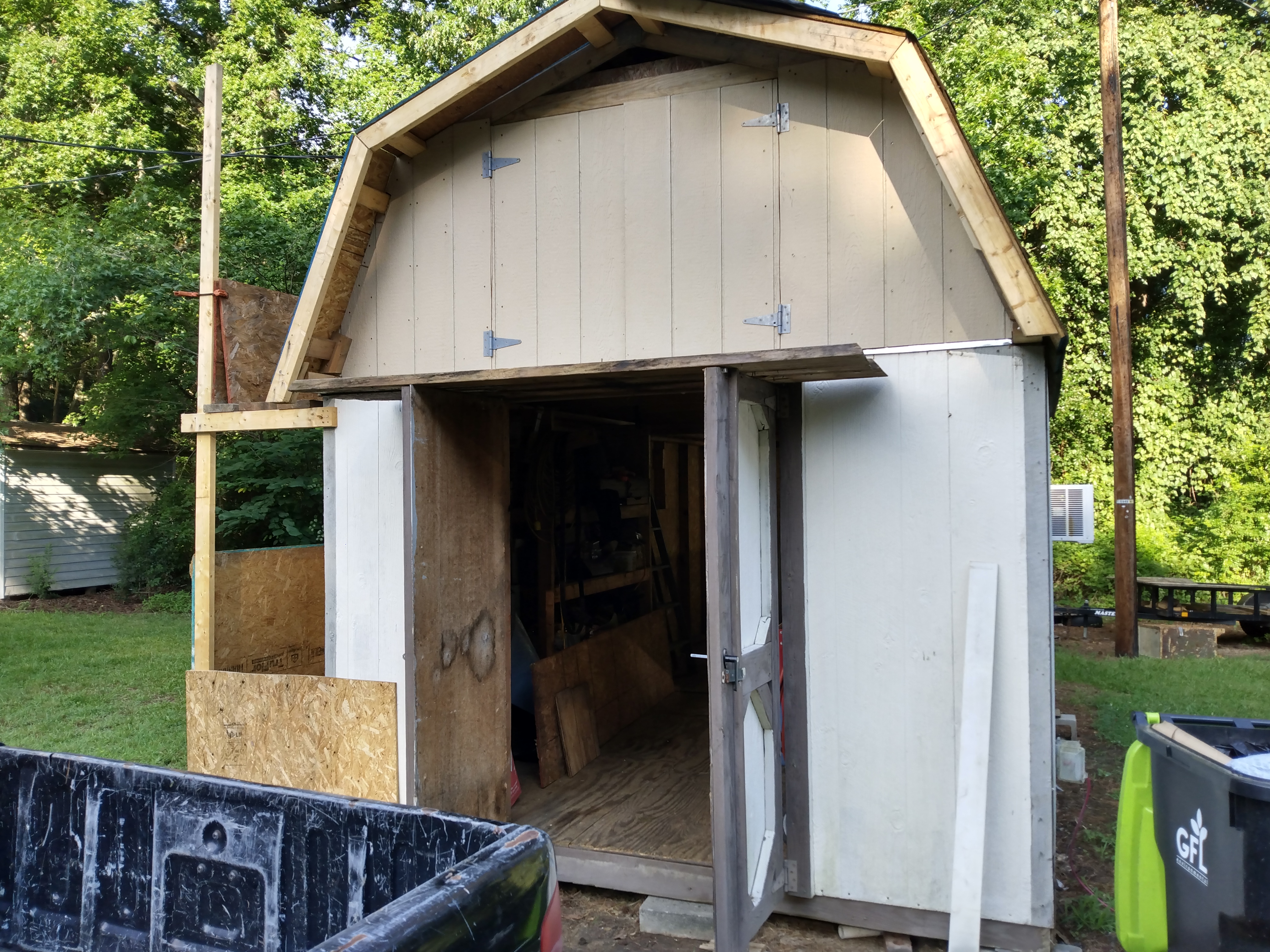

Loft doors trimmed. Building scaffolding over doors anyway. My 16 foot extension ladder just gets too floppy for me when stretched out to reach peak. Have to build a work surface. Likely won't use the boards on the doors as shown and will bring couple of the 14 foot 2x8 over instead. Going to build a 2x4 framework that allows the doors to function with scaffolding in place. Plan to add trim once everything is painted and that will require detailed measurements. Have to get eyeball to eyeball with it for that.

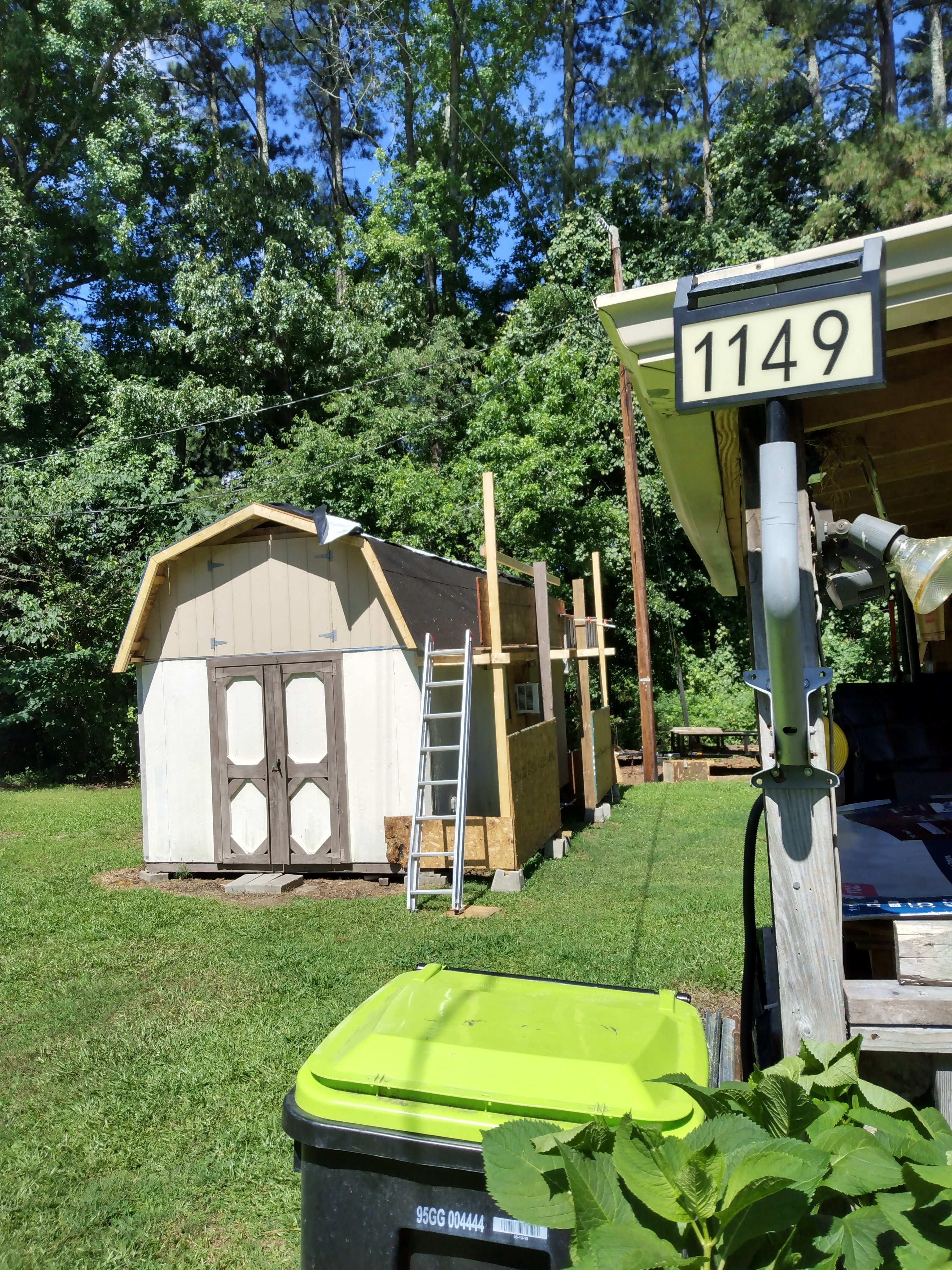

Neighbor came over and said maybe we can lay the rest of the underlayment this evening when the shade spreads out. Earlier when it was 85 said "feels like" was 100. Brutal. It's 89 now & feels like 98. Pulled those boards off the doors. Will just build scaffolding over the doorway so can shut the doors.
The under is laid. Nextdoor neighbor got it did. I helped on the lower section but he did the climbing for peak. He needs clutch in his 2001 BMW 525. I'll have to buy few tools. Think they have spline drive bolts?
