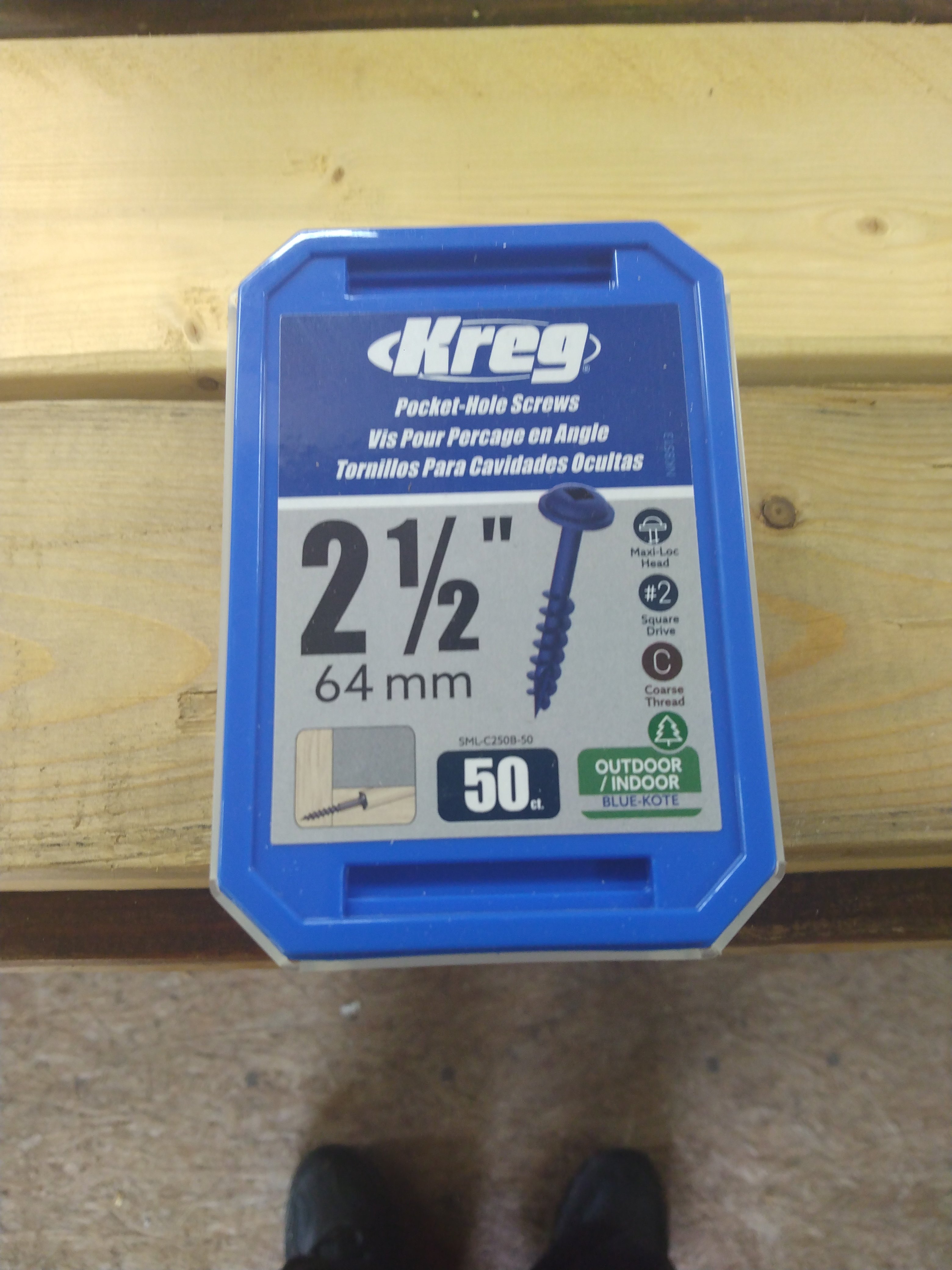

Didn't remember the "long" Kreg screws are 2.5". Thought inch or so more. Have 4" torx screws that would probably be fine but don't want to chance splitting the wood. Possibly take the existing new door down so can drill the crossmembers for pocket holes. Could then trim top of door siding or just mount the door inch or so lower to get clearance. I like having the siding overhang the top plate tho.

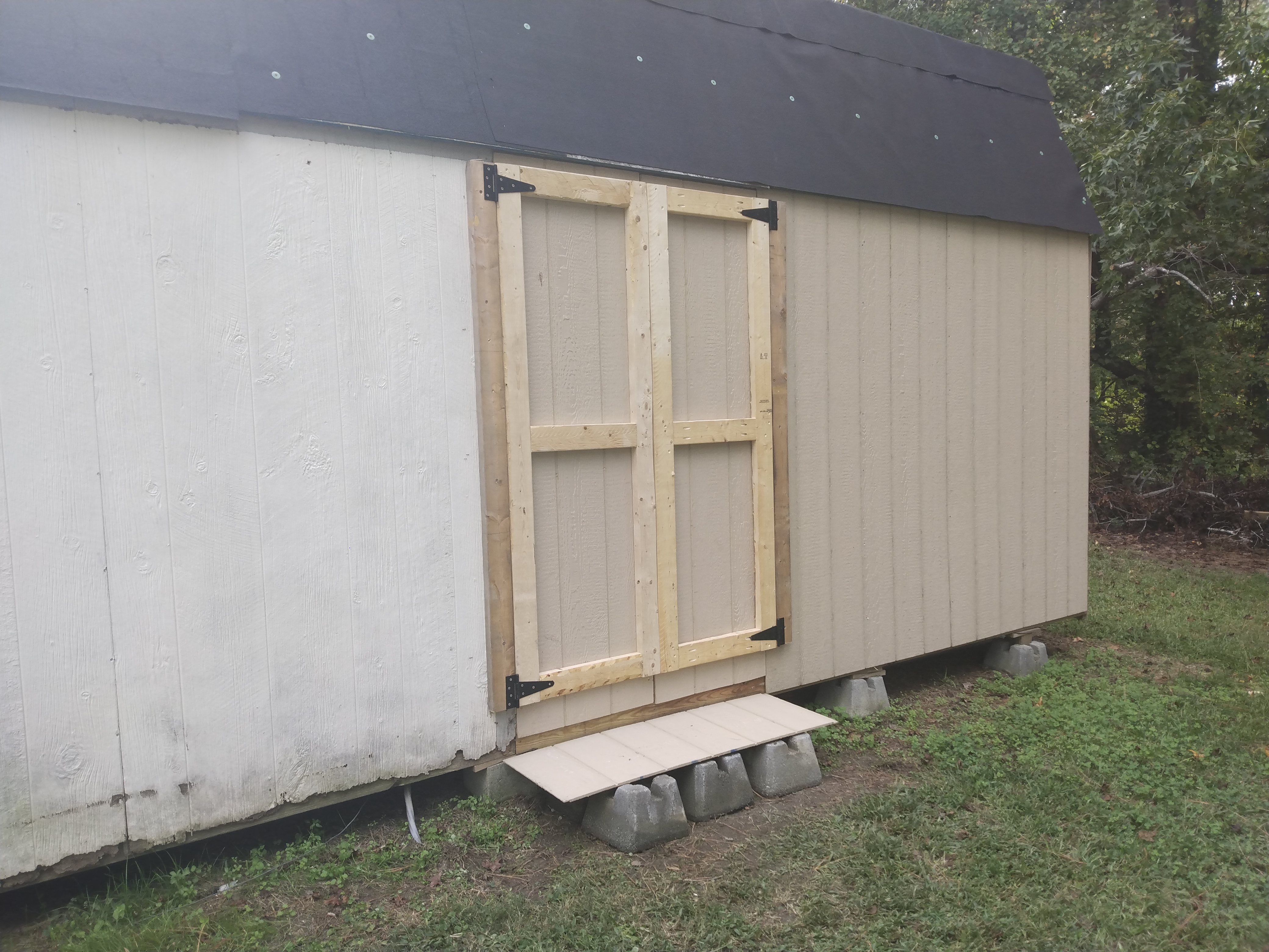

The doors, door. Need to add some trim to cover the hackery and put handle on. Might just use the old school 2x4 across inner side of opening. Have the fancy handle like on front but requires drilling a hole and putting in couple screws. Have two more hinges to install.

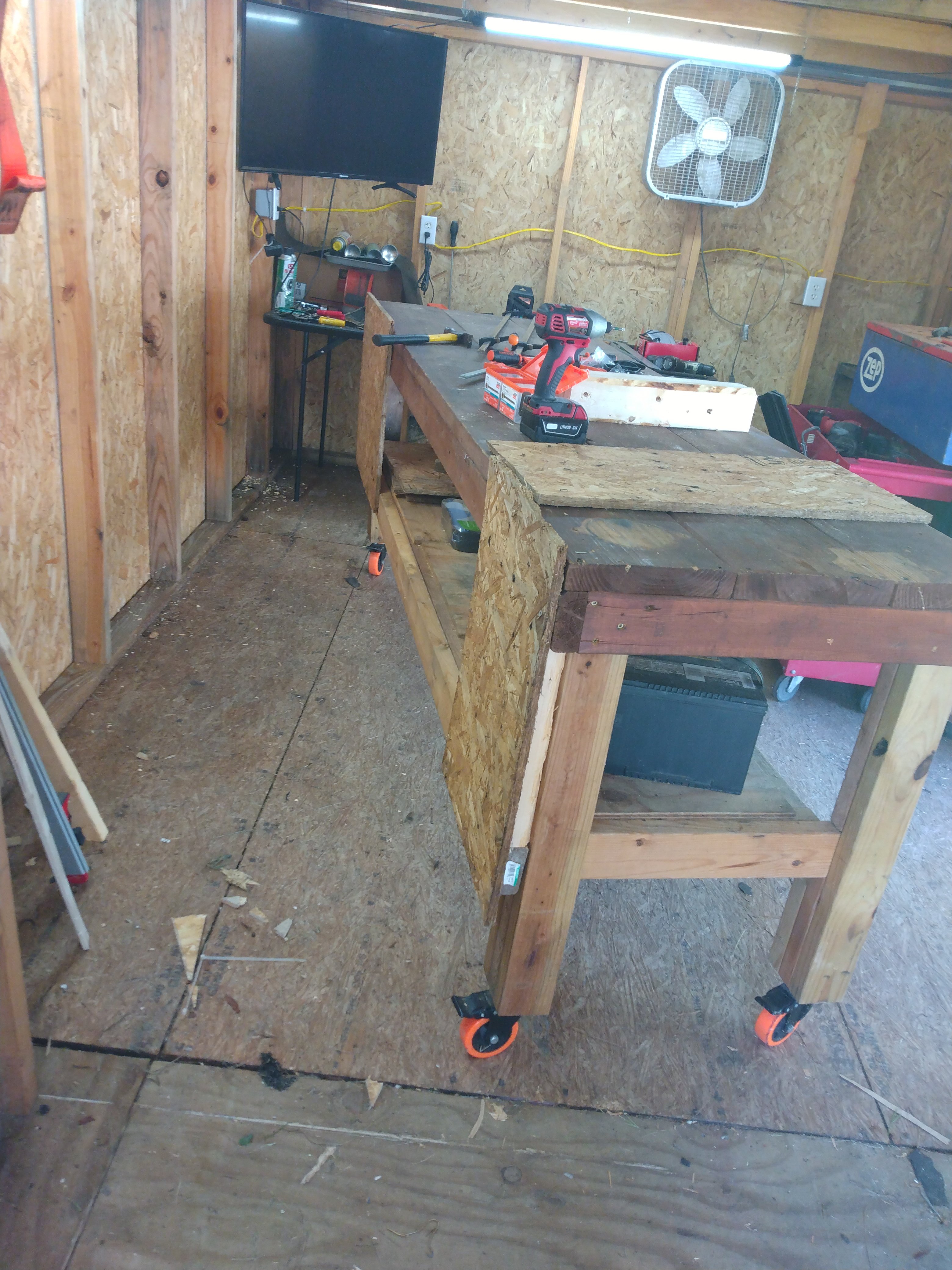

Did some things today but no shingles laid. Did stick some OSB on back & sides of bench to brace the legs. Did several things but the bench is all I can remember. Think maybe possibly figured out way to cut the roof OSB off probably maybe possibly 3.75 inches or so. Screw a board to roof @ about inch from edge to use as a guide. Let saw sit on that and away we go. And we have Coyotes or something eating the cats. Had couple that slept on my porch that disappeared months or so ago. Landowner mentioned others said they gone missing.
Really need to drag everything outside so can sweep/vacuum up all the refugees. OH! That's another thing I did. Took bedroom TV out to the shed. Wireless Internetz works just fine. Do i need it out there? Probably not.

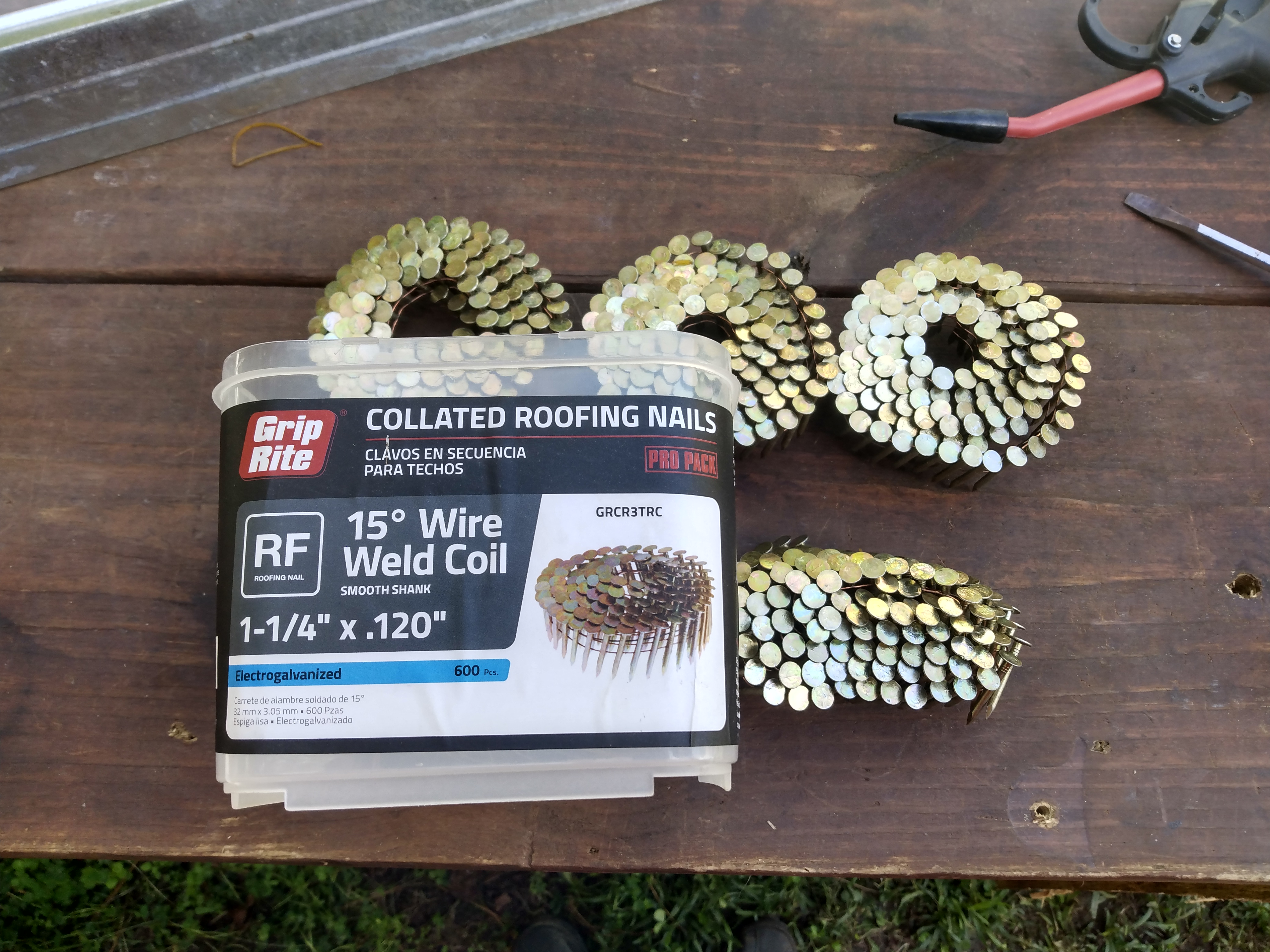

Yet another thing...the 1 & 1/4 roofing nails aren't 1 & 1/4. Maybe could stretch it to say 1 & 1/8? One box was all wadded up. Had to unroll and reroll to get them in the gun. Cheap junk is never worth the expense.

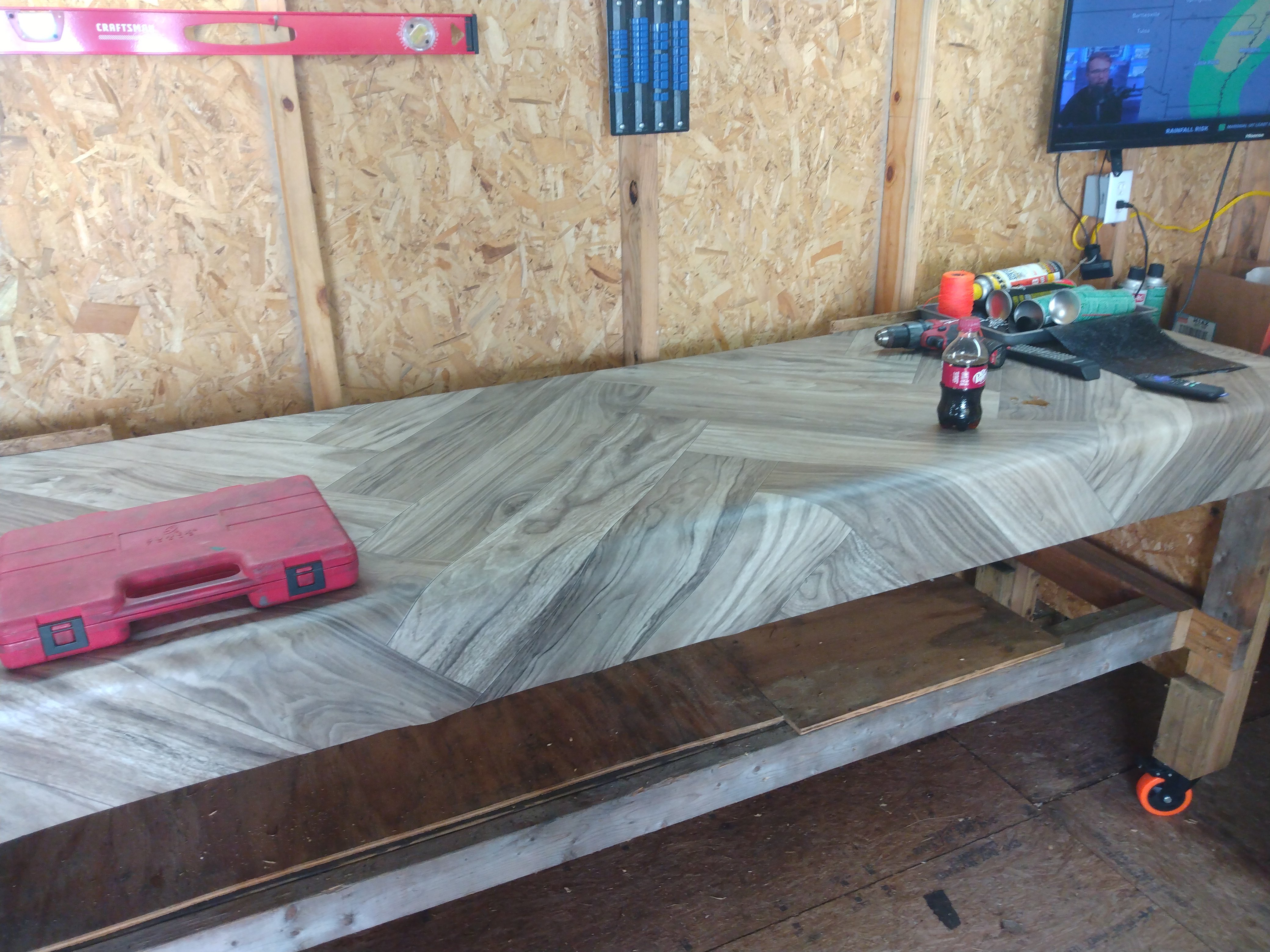

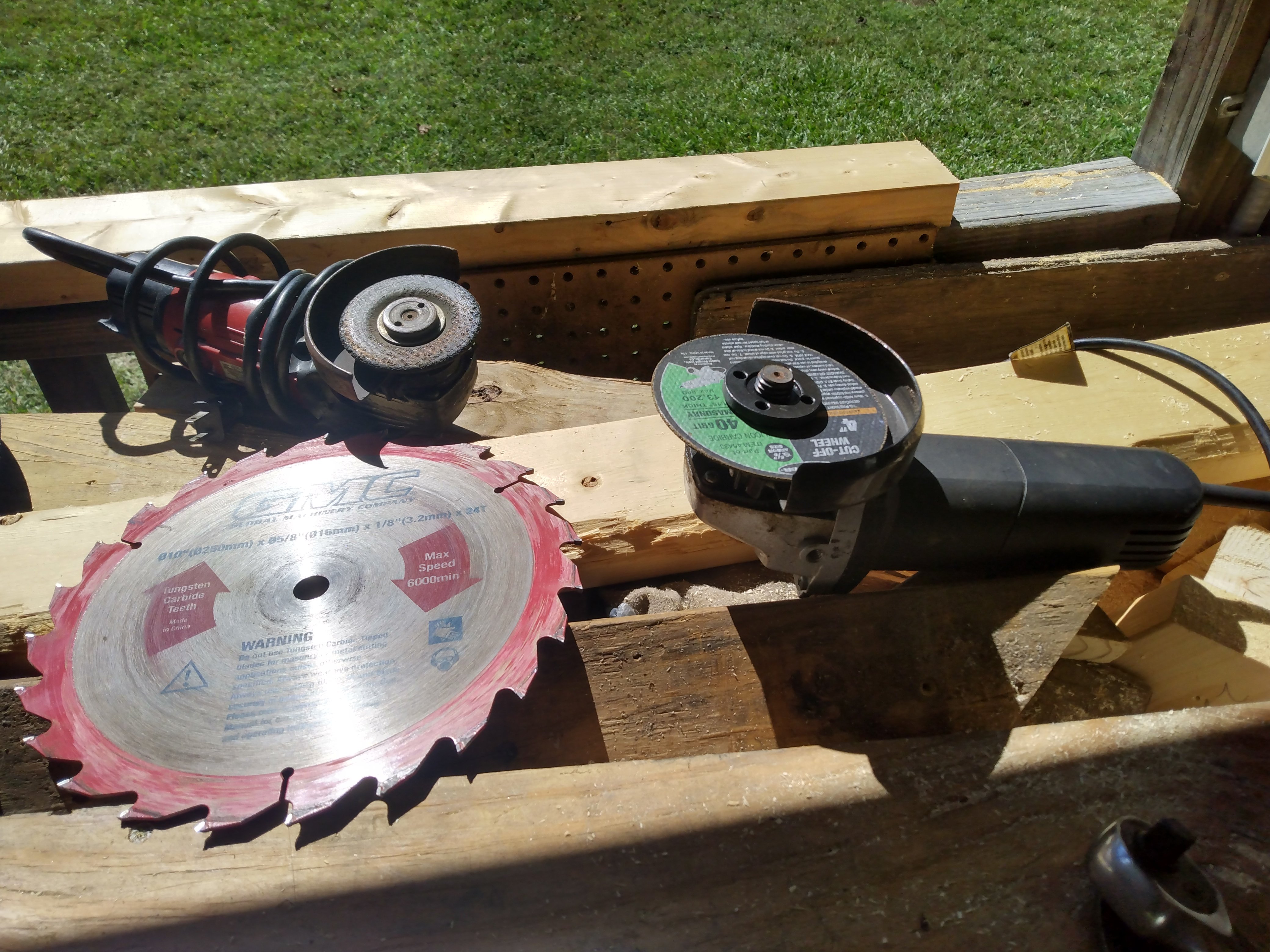

I be doing stuff. Finally got the blade off the sliding miter saw. Original owner apparently didn't know it's left hand thread. Will order a new bolt. Changed blade on circular saw too. Cuts like butter now. Quite possible my struggles cutting a straight line was related to the blade having cut waàaày too many nails? Was shoving it thru the boards. Cobbled a small shelf in the corner. Have plenty of shelf space it's just covered with junk.IMG_20251006_122553204_HDR.jpg

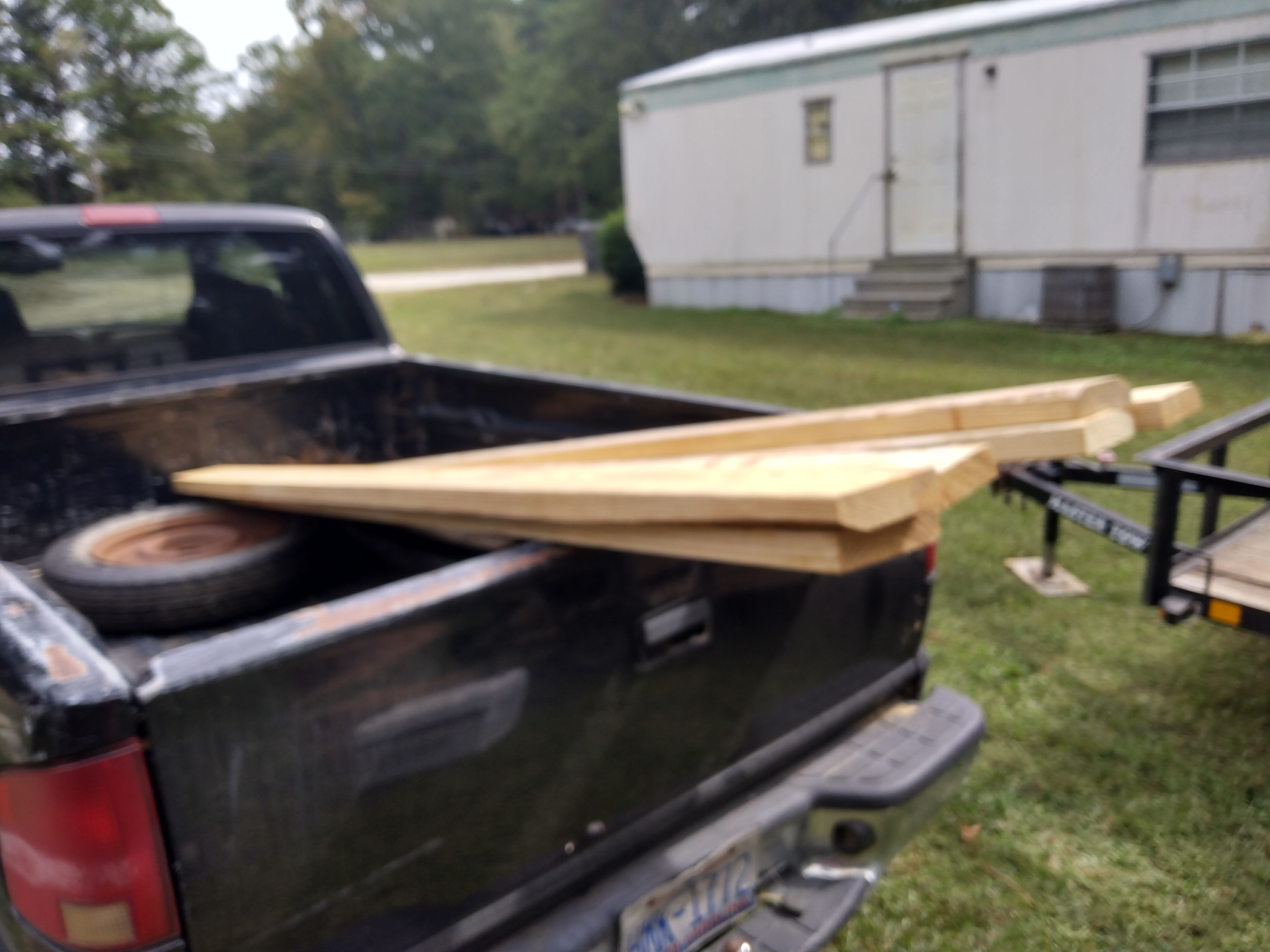

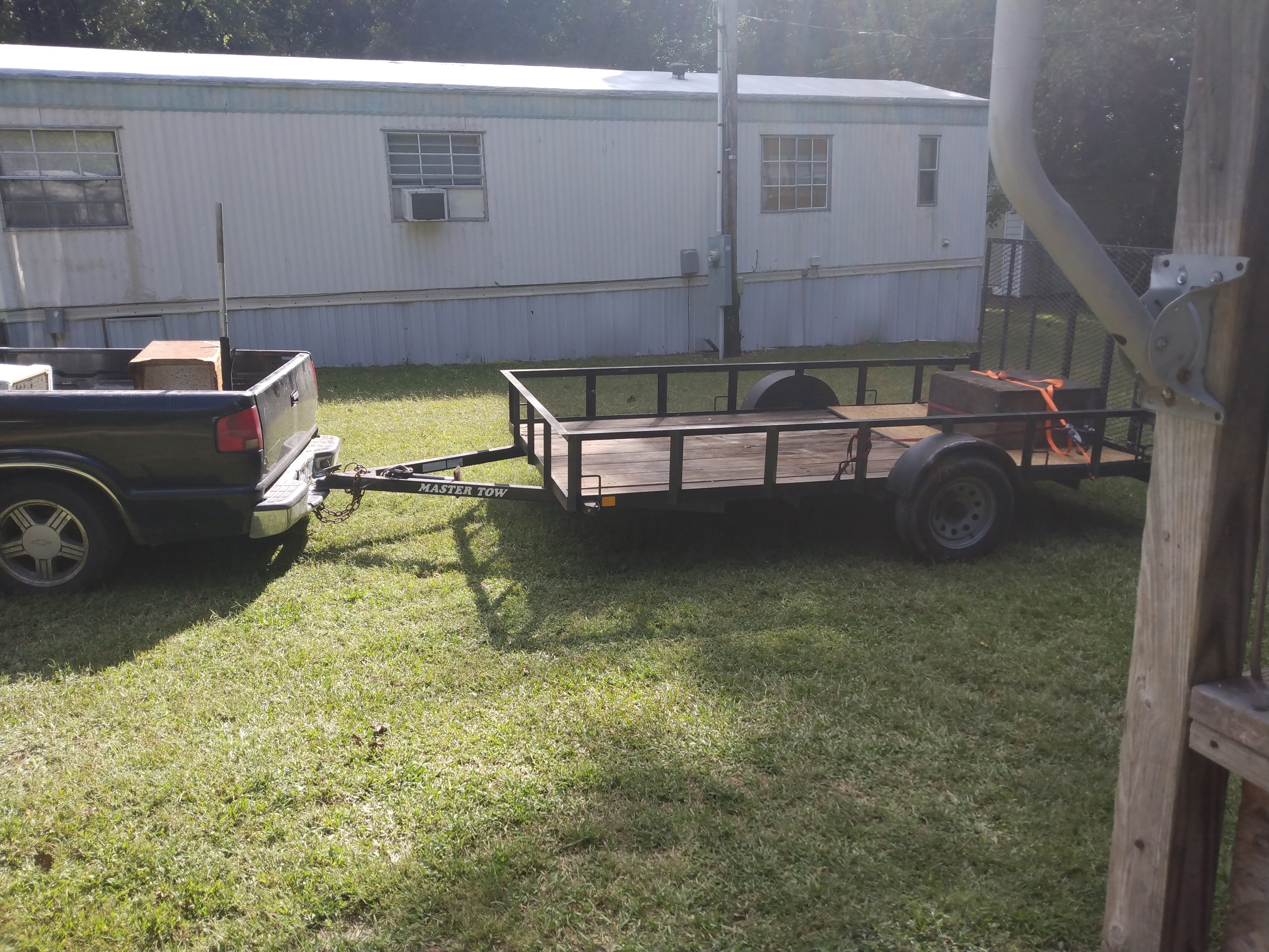

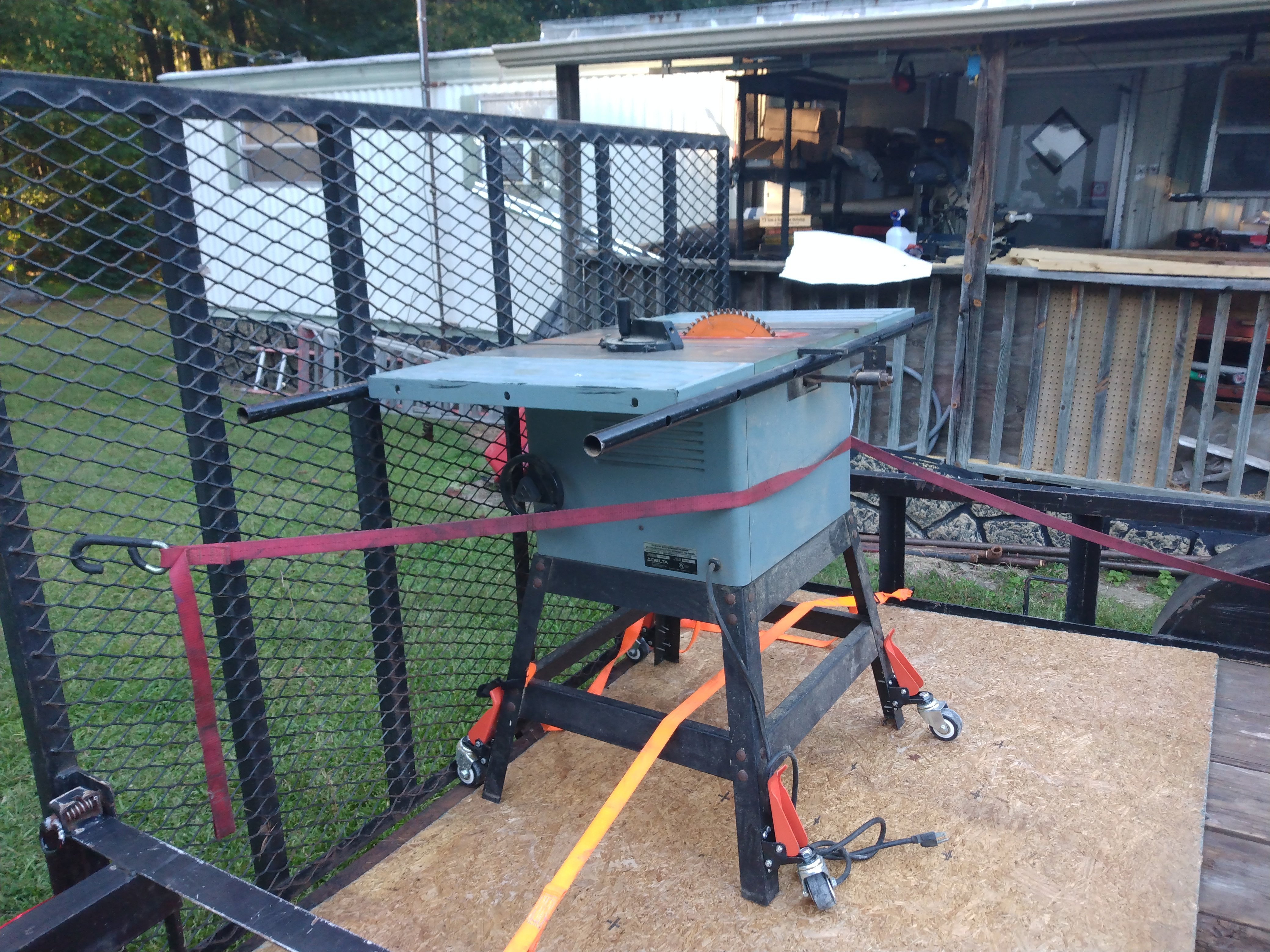

Not sure how to pick up the table saw. Tempted to take trailer and just leave it on the trailer instead of jamming it on the porch. Plus will likely have to load myself and not sure can get on my S10 alone.
Ordered new bolt which comes in pack of two. 8ish bucks. Going to clean off the trailer and get it ready. Certain can do it that way so won't have to disassemble the saw as it has a home built outfeed table on the end. Might not be heavy at all but...

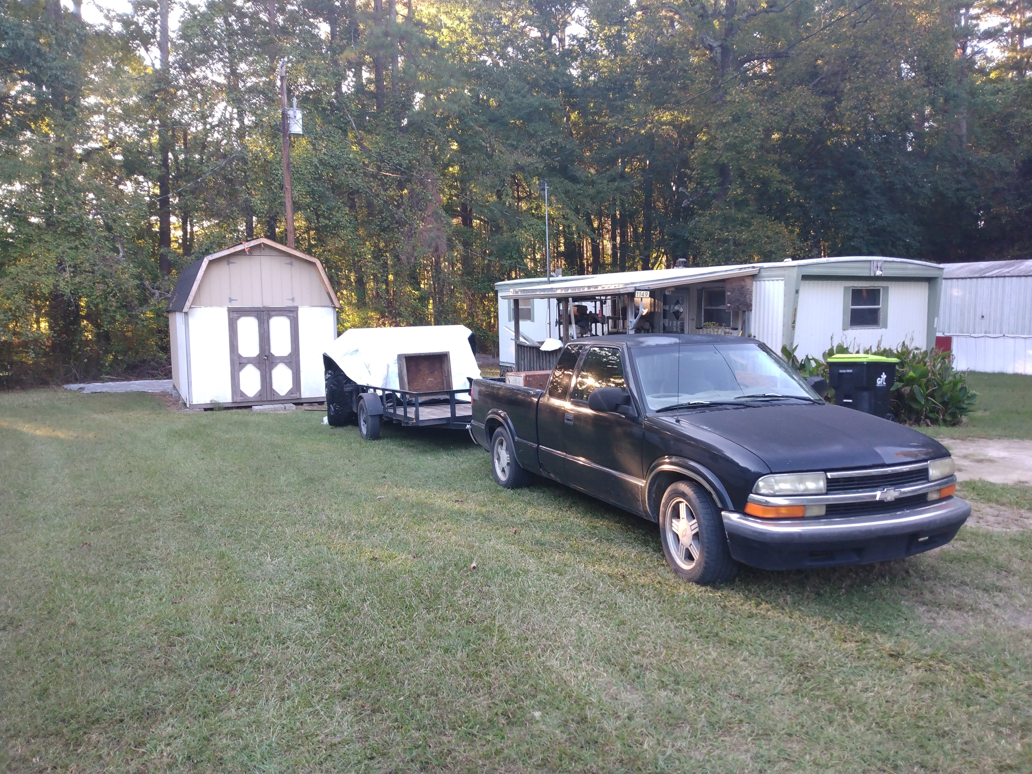

Trailer is ready to roll except right taillight seems to have quit. Or a wire is broke. I don't care. LED lights I put on and replaced all the wiring. Something quit working. No idea where my test light is hiding. Have voltmeter but that would require cutting wires. Not gonna do it.IMG_20251006_150542255.jpg

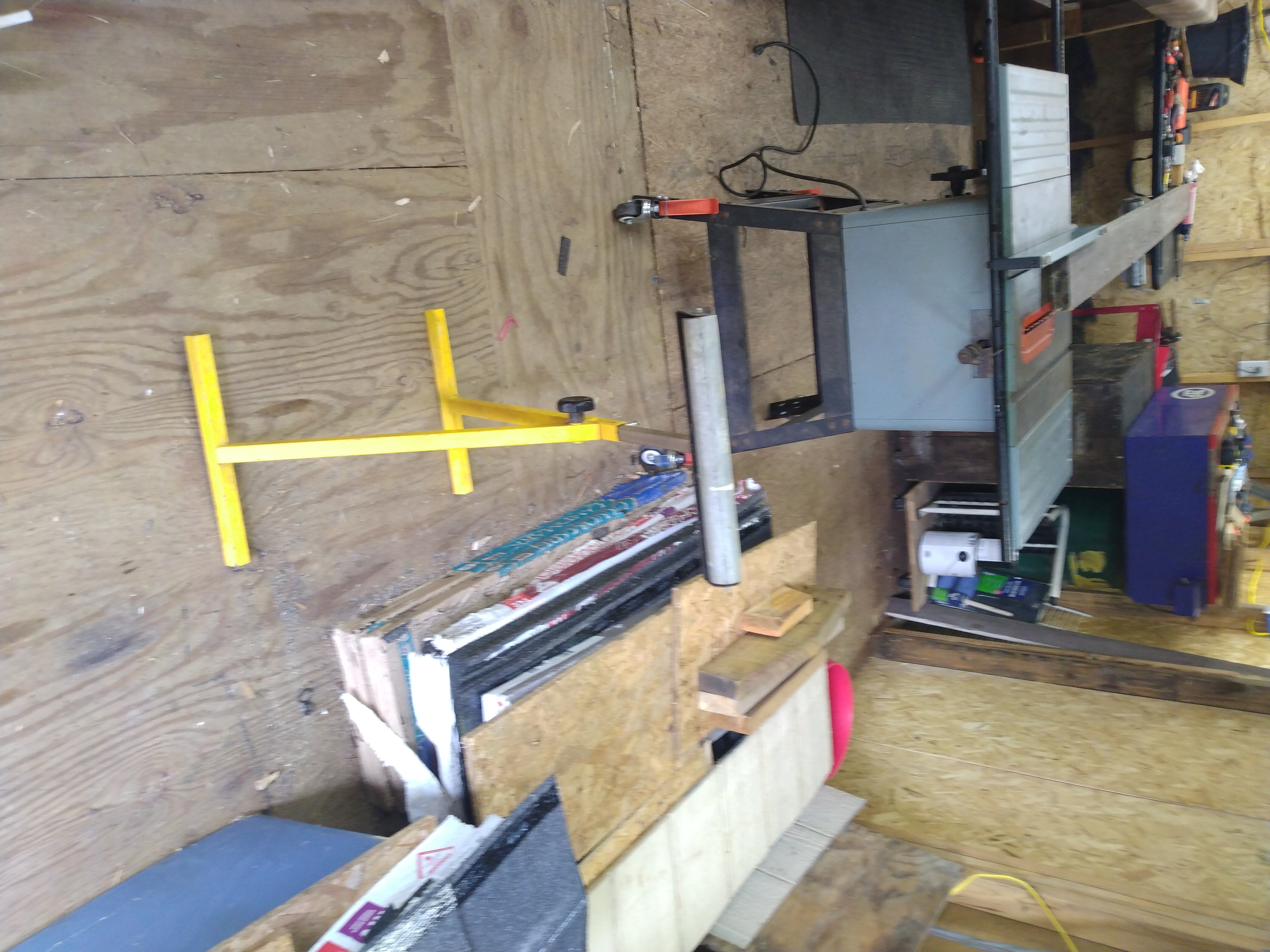

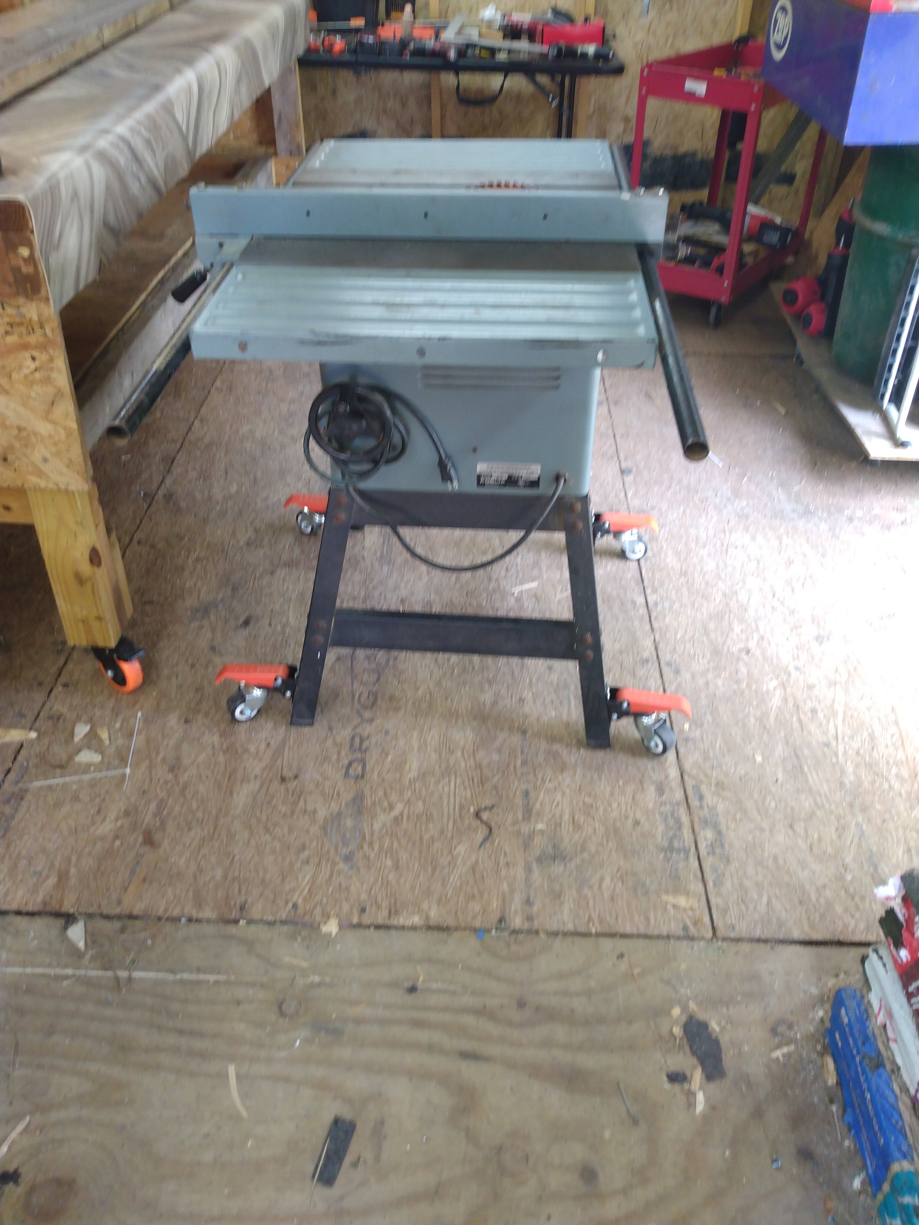

Stuffed it in the shed. Have to design functional wheels. It's easier to drag than try to get those floppy casters to work. I suppose may end up tall enough to match the shed bench then? Didn't want to use it in the shed as noisy and tons of dust. But whatever. I got tired of sweating and measuring chit over and over.

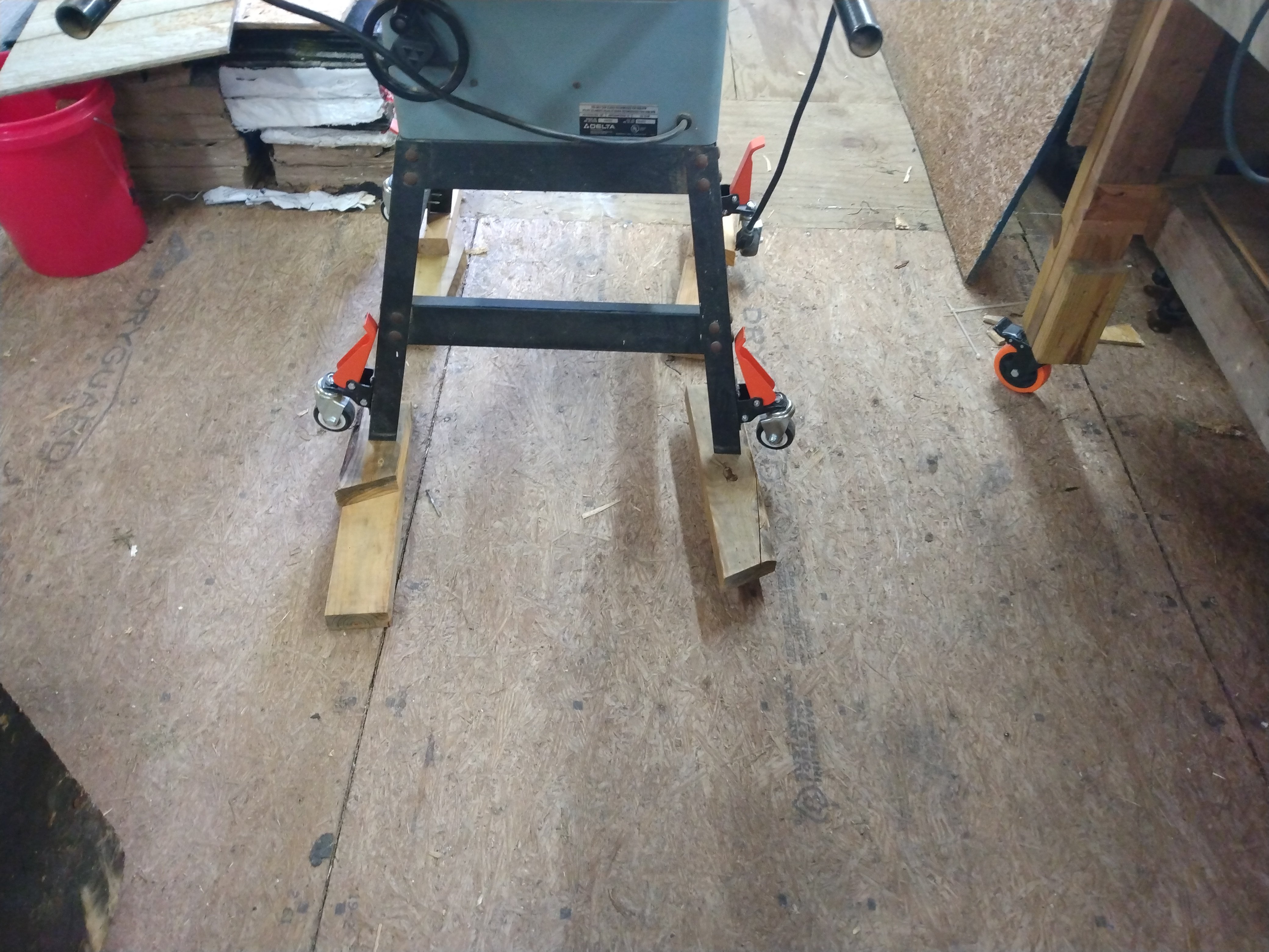

Two 2x4 stacked (1.5 + 1.5) with piece of 1/2" plywood over gets saw up to where the shed bench will work for in-feed. I'm more worried about that than the out- feed. Still might build a base structure/box for the porch. Really like to put it somewhere and leave it. The stand is 26x24. Wouldn't want to make square would you?😉IMG_20251007_145248208.jpg
Just occurred to me, could just line them up, remove the wheels from the bench. Think be really close on height. Close enough to slip small piece of OSB under it to tune it.
Two stands for 10 bucks in Wilson. About hour drive for the whole trip. Perfect! Waiting on the magic fingers to be delivered plus have eye Doc appointment at noon. Gonna cut an old board as a test.

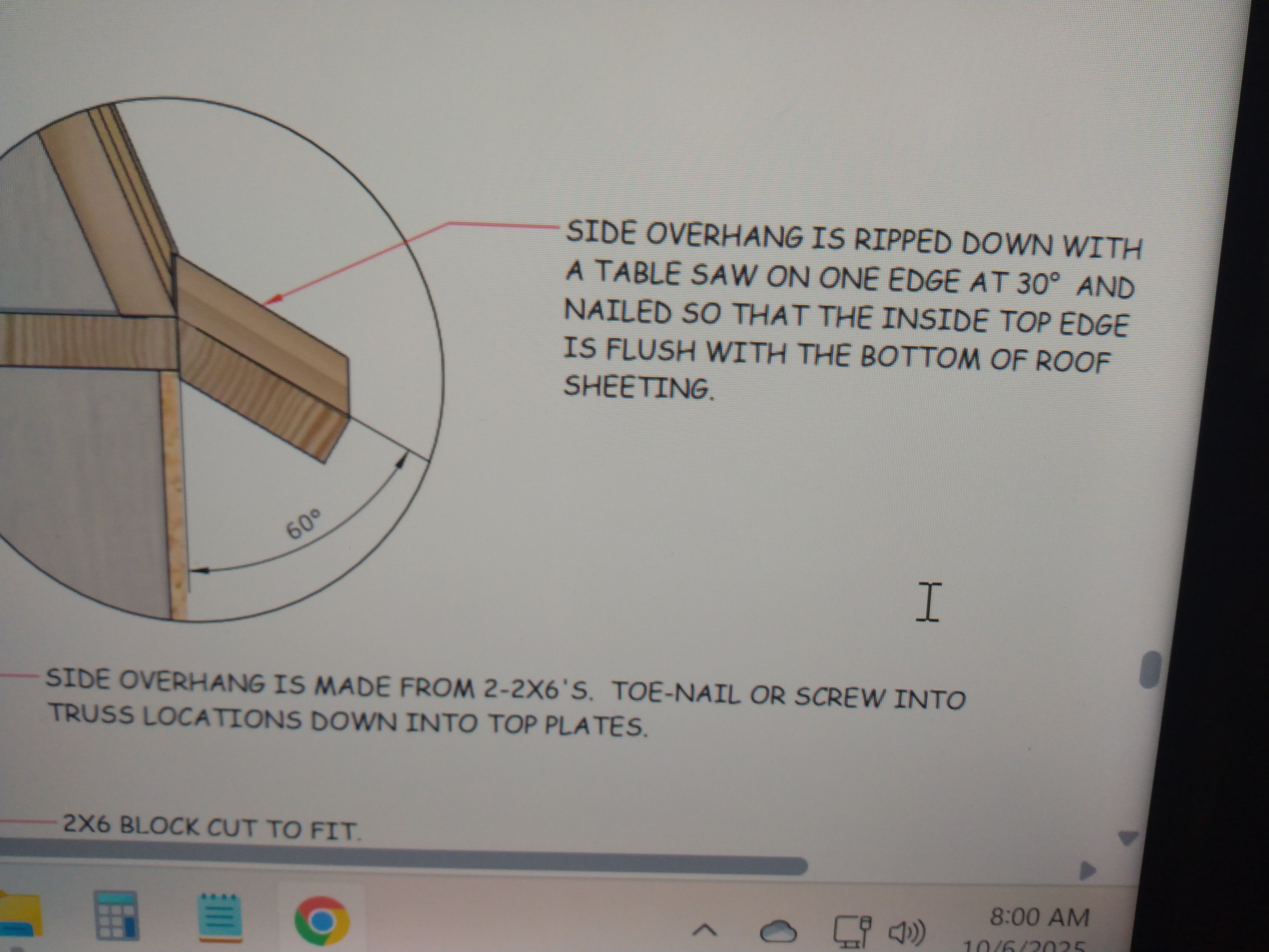

Did. Not. A. Thing. Just not feeling it. Think will use eight foot boards to make the install easier. Tree thymes eight = 20-4. Roof is currently 23 feet so could add an overhang to back wall easy enough.
Oh...the shed plans are from Shedking. He does this style overhang all way around on gambrel roof. Pretty slick, slick.

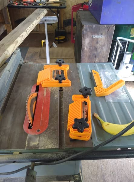

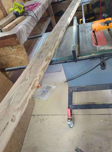

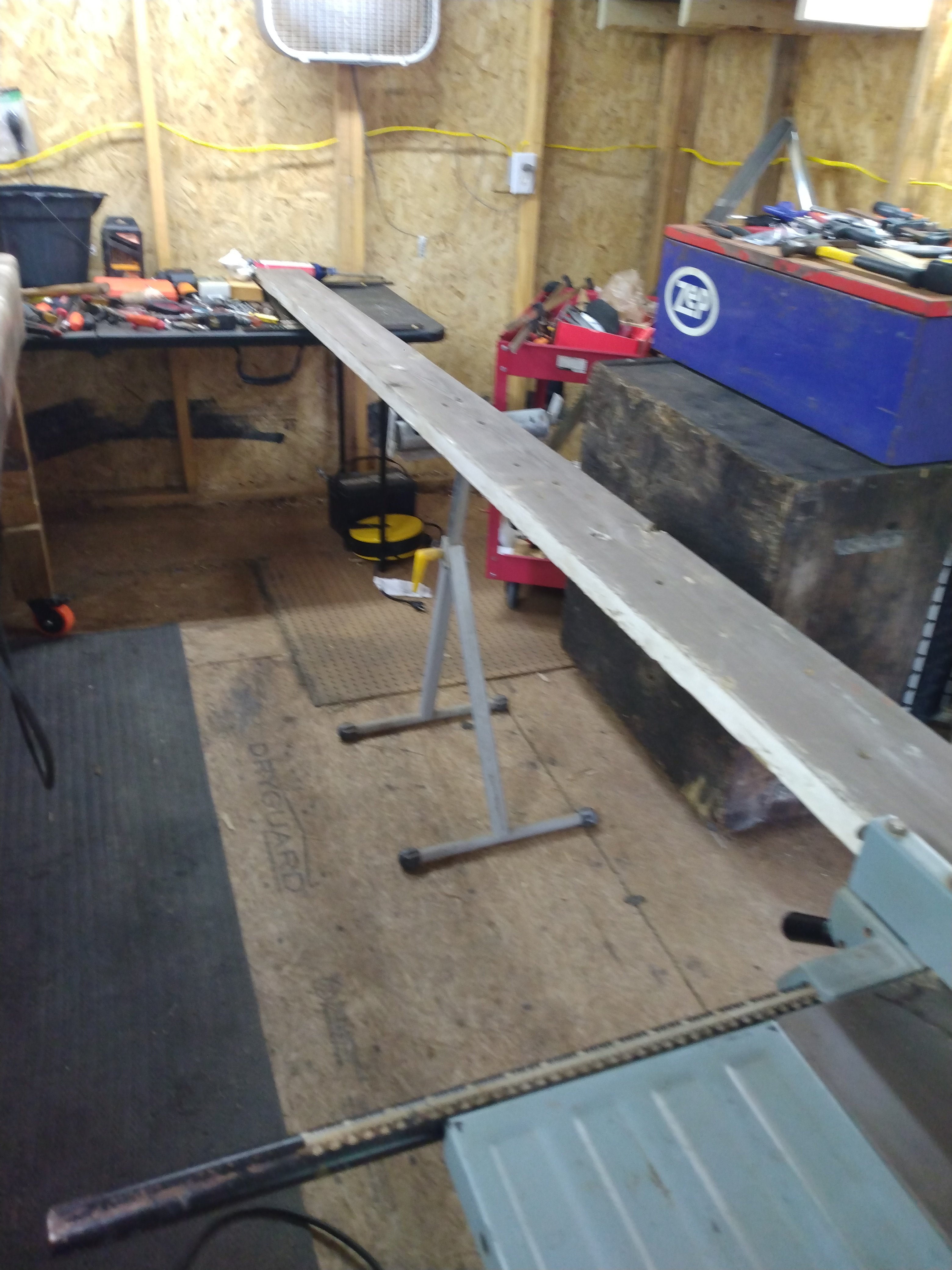

It works! Suspect a new blade would make it easier but think it's good enough for now. Cut one of the old edge trim boards as a test. Board has to be close to 25 years old and was outside whole time. Little cupped up which they say is a no no. But it worked. Started and stopped I think 4 times to reposition props. Would really prefer the board be fed into and off the saw onto a bench. Suppose need to build some sawhorses...
Banana for scale. Suspect next cuts on new boards will be done outside. What. A. Mess! I'll create a temporary "porch" at front door so can rollish the saw out. Maybe use truck bed as the outfeed? Alls I know is have about 6 hours to waste before dark comes. Fairly certain I'll waste most of that time moving stuff around.

The side overhang isn't gonna be as pretty as I'd hoped. Did finish getting the side doors sorted. The table saw already blew up. Started popping 20 amp breaker. Possible just needs brushes in the motor. Got 4 of six boards ripped and the saw started giving up on the 5th. So guess will just have the barn"ish style on the door side where needed it. Worked little over 5 hours and just about had to sleep in the shed. Barely got stuff put away then stumbled inside. Sitting with heating pad behind me. Have to attach one more board and figure out the angles for wedges to put under them every 2 to 4 feet. Have to get a picture later when not in my birthday suit.

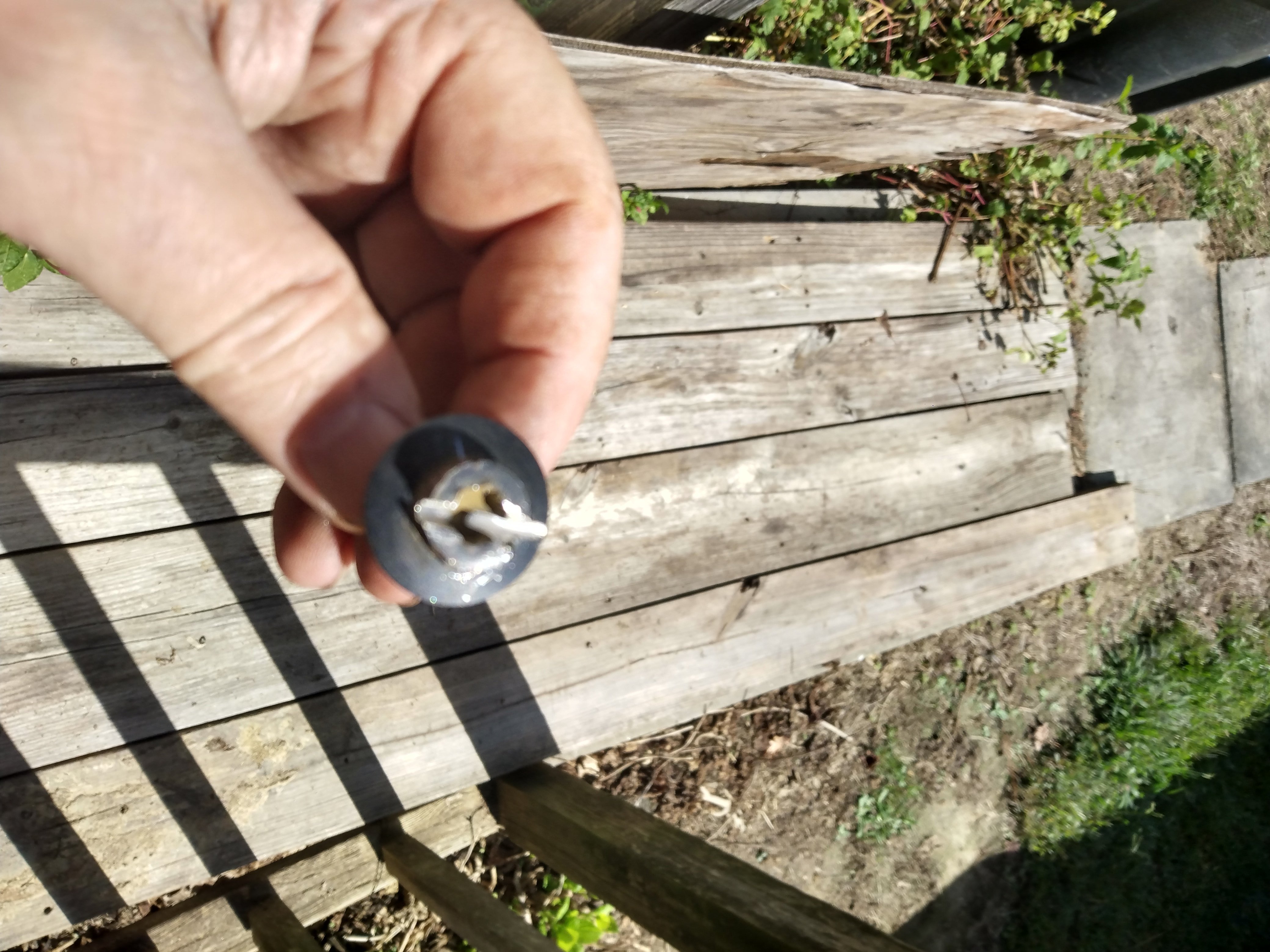

The WRONG brushes came in. Removed the old ones to make sure that is the problem. One was the wrong part and was definitely an issue, Brush was too long so they jammed the plastic cap/plug in so of course the plastic cap broke when removed. Probably could superglue it but...
After bunch of searching finally stumbled onto a kit of brushes, They are just about every possible size for tools. $9.64 for 40 piece set. Five brush retaining caps for 6.42. Hope the belt is correct. Did get to that yet.
Saw is upside down to access one of the brushes. Possible I'll further disassemble and modify an existing bench to incorporate the saw. Mainly if disassemble can carry the pieces to the porch for reassembly.
