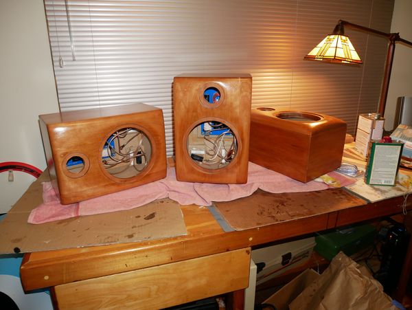

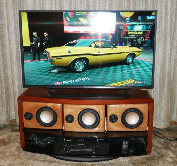

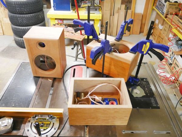

I made some speakers for a 3.1 system for my secondary TV. My original design was to make some black boxes to fit in the TV console. But I decided to test my skills by finishing them with cherry veneer and a 5/4 (1-1/4") cherry face. I got the crossover design from a customer design at Parts Express (crossovers are a dark art), this design has an off the shelf crossover with a resisters, capacitors, and inductors added.

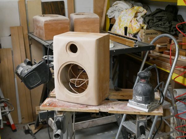

I routed the edges of the face with a 3/4" bit but it still looked too square to me. So I used a plane and sander to shape the face.
Then I finished them with tung oil. I try to do finishing in the spring or fall when the furnace isn't running but I missed the window this year. Finishing is a pain fighting dust in my house (maybe I should adjust my cleaning frequency).
The current assignment for these speakers is as a fancy soundbar. They should out last the TV console and they will be good for a set up with a little more stereo seperation. I considered matching the cherry stain of the console but decided the natural look will be better for the speakers future use. I'll be building a subwoofer to replace the cheap one I'm using for this application sometime down the road.
They look awesome! I'm sure the sound is the same.....
