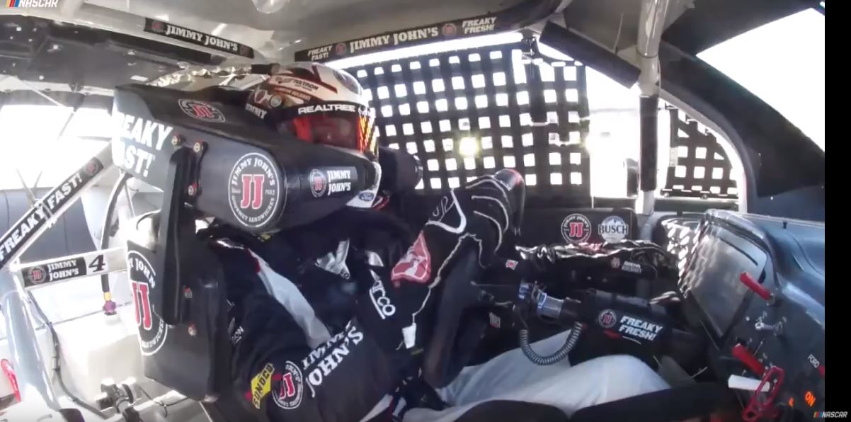

It makes me think it is mechanically controlled, something is pulling it down and then pushing it back out. Wedge, trackbar adjuster? I am just throwing spaghetti at the wall but I agree with you. That is a lot of flex to show zero evidence of deformation.
Somebody on reddit posted that theory as well. There's a clip of him using some switch on his dash. Trackbar switches are typically mounted on the steering wheel.
Somebody on Reddit pointed this out...
Here's a shot of Harvick messing with a switch and looking out the rearview post-race. Could be rigged up for manual control?
That is what I am wondering, could the trackbar motor being driving it? Total speculation obviously, I would need someone smarter than me to shed some light.
I can only imagine how crazy the penalty would be if something like that turns out to be the case. :eek:
