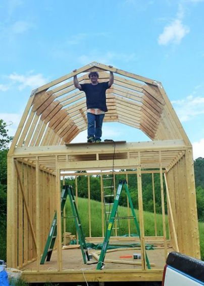

Needs power washing and some repair of lower siding. This is what I want to do for roof. 12 foot gambrel would be perfect.

Just occurred to me, after raising the top of walls to gain head room (may only be 6 inches) will put stringers across then plywood it to about 6 inches from walls to leave room for truss. Build truss on that surface. Won't have to lift them. Tack a couple verticals outside of front & rear wall to catch them, Then just flip them up and nail to stringers. Add hurricane ties. Main reason I'm dragging my feet is I have almost zero building experience so doing lots of research. Need to use 2x6 so can bird mouth for top plate so maybe need to use rope and pully set-up tp lift them? I'll be doing everything by myself. Actually prefer that.
My concern on the wall height is don't plan to recess lights and they would be head knockers. Suppose if they are up in space between stingers that would be fine. Me thinking...

Was going to mount saw on an old tool chest but this was in old storage building. Maybe attach locking wheels to bottom and add wings to sides? I hate thowing stuff away that can be repurposed. Calculating how many 2x6 for roof truss. Not sure whether to go 16" o/c or 24? Since pitch will be higher probably not a concern. 24 should be fine with 1/2" OSB sheeting. Since building is 10 foot planning on running truss past end an extra 2 foot. Then when money suits extend building on back another 12 or 200 feet. Hmmmm? Suppose foot overhand front & back would make me look less insane & still make it easier to add to back and make a "porch" later so I don't get my dumb head wet in the rain.

Gonna do the barn roof on shed with 2x4 rafters, two 2x6 loft and fix front porch roof. That'll about break me but at least have dry place to put my stuff. May get landlord to pay for porch materials which are only around $200. Knocks it off the rent. In nearly 8 years I've lived here doubt she's spent $500 maintaining this trailer. Pretty cheap. I don't tear stuff up.
