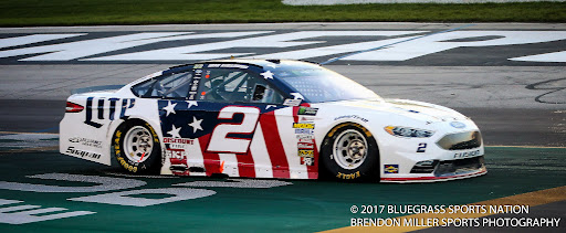

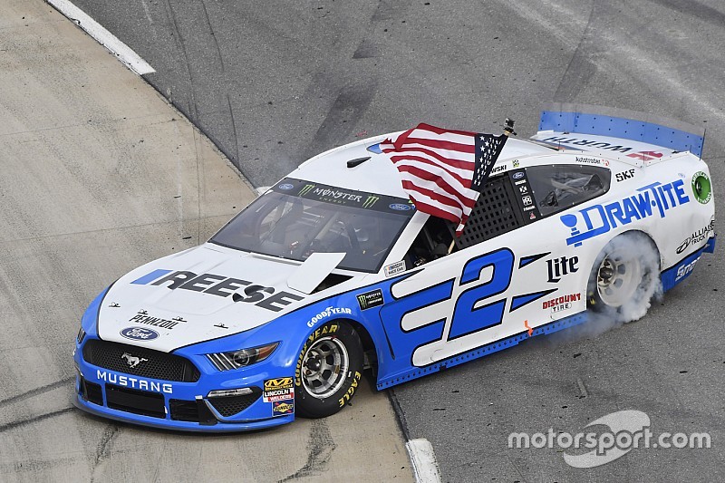

Graphic proof of the "penalties" of driving in deeper and harder than anyone else at Martinsville...

Brad doesn't talk about driving Martinsville. He does it, and he's had a lot of success doing it. It's plain to everyone watching that he gets into the corners harder and deeper than most all the others. It's how he passes people, which is the point after all.
In the MotoGP race yesterday at Misano, almost every passing attempt was an out-braking at corner entry. Same as F1, until you introduce an aero anomaly like DRS into the equation. There's not much of a trade off between corner entry and corner exit. Time can be gained, or lost, on either or on both. Especially at Marrtinsville, where the apex is a long, long arc that follows the shape and radius of the inner curb, which physically separates corner entry from exit (unless you are diamond-ing the corner).
Larger diameter rotors 3" front and 2" in the rear along with the more efficient calipers adds over 33% more braking according to Larry Mac. If a driver can't manage that large of an improvement they have a problem and need to change their driving habits, because they are going to use less brake use to slow down.
33% more than WHICH package?
In the MotoGP race yesterday at Misano, almost every passing attempt was an out-braking at corner entry. Same as F1, until you introduce an aero anomaly like DRS into the equation. There's not much of a trade off between corner entry and corner exit. Time can be gained, or lost, on either or on both. Especially at Marrtinsville, where the apex is a long, long arc that follows the shape and radius of the inner curb.
So, if I beat you into the corner it's because I'm on the brakes harder and NOT because I'm using LESS brakes and rolling the car in? I believe the term is "backing-the-corner-up".
